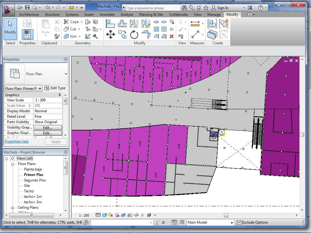

Hello everyone.
I have a simple problem I can t figure out. I have set my overlay to show the floor immediately above. This works fine but is shows me everything above. I want it to show me ONLY the voids. I do not need it to show me the walls for example. Please help me out.
Wed, Oct 17, 2012 at 10:01:05 AM | Select overlay objects to be shown
Sorry but an underlay is the entire model.  You can then select individual lines as overhead.
