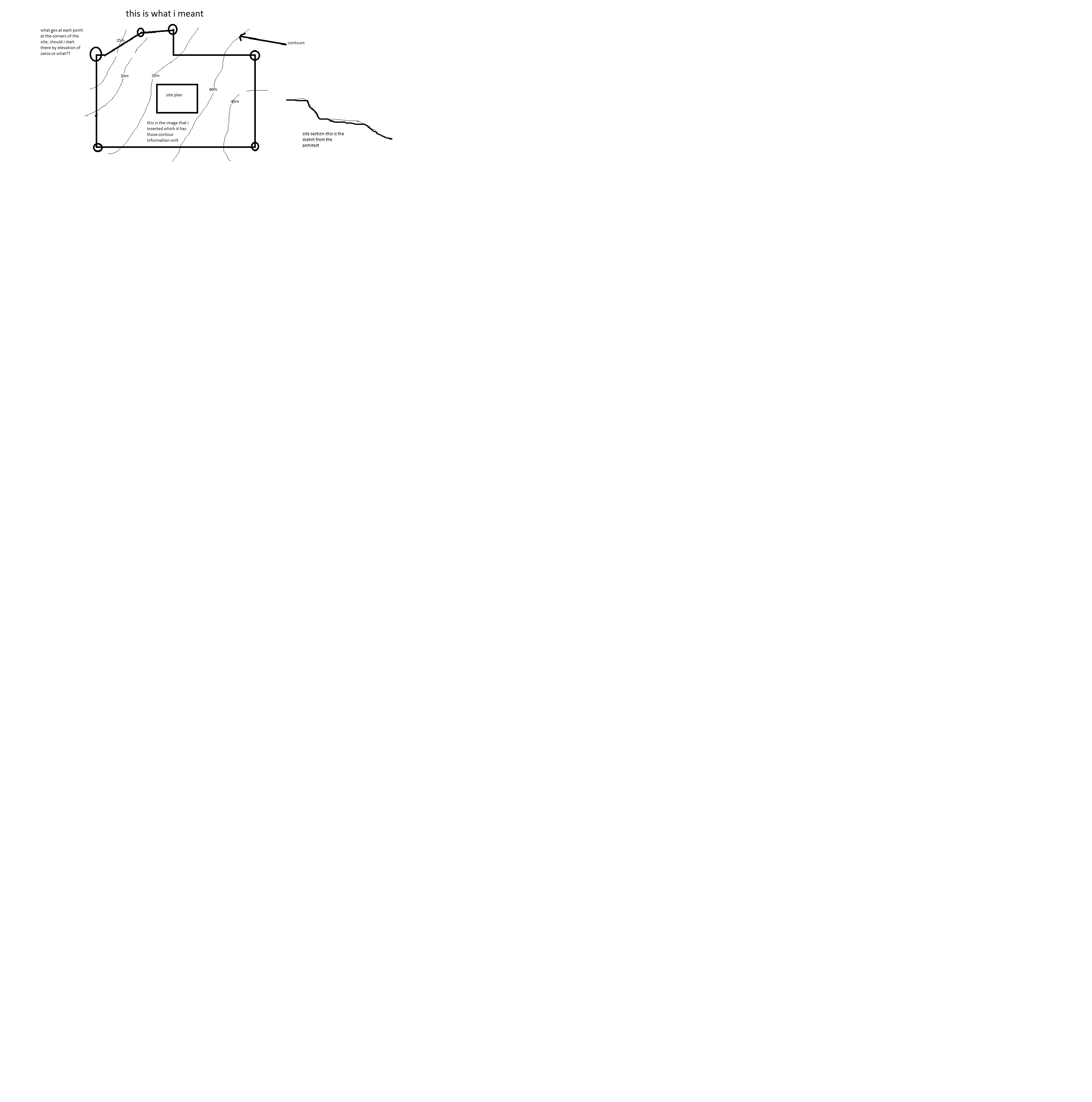

Thanks for your reply iam familar with working on dwg site plan and how to insert them,
we dont get dwg or any other format to work on site plans the architec just sketch how the site might look like and than we just go online using Crying google GIS maps) and find the site addres and than copy it as image format than insert it into revit.
for example the inserted image got four contour lines that runs around the site each goes like 5m,10m,15,20m apart lets say the site overall shape is a rectangular box how to make this happen what goes first, should i start by elevation of zeros first and than use the contours numbers
the problem is i dont know how to start this process, should i use elevation of zeros first around the boundary of the site and than put down the elevation numbers from the image? because everytime i end up with a different site section from the architec sketch
i know iam missing a really small thing on this but its confusing me alot, and iam running out of time
yet again thank you for your time
Thu, Oct 18, 2012 at 7:13:35 AM | Site Topo/help!!!!
Whtever the countor line is, just place points at that elevation along it, including if it crosses the property line.
