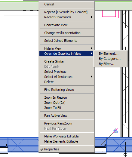

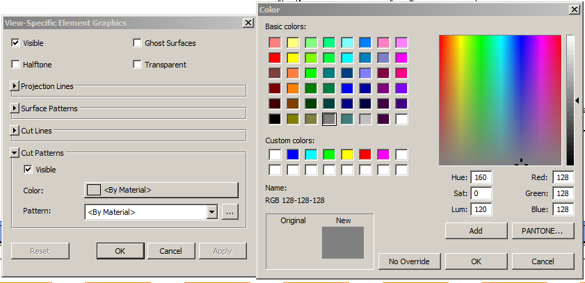

Tue, Jan 21, 2014 at 2:40:02 PM | Concrete hatching ?
See the attached images.  Choose your items by selecting individually, by category or create a filter, then change the fill color to your grey.
