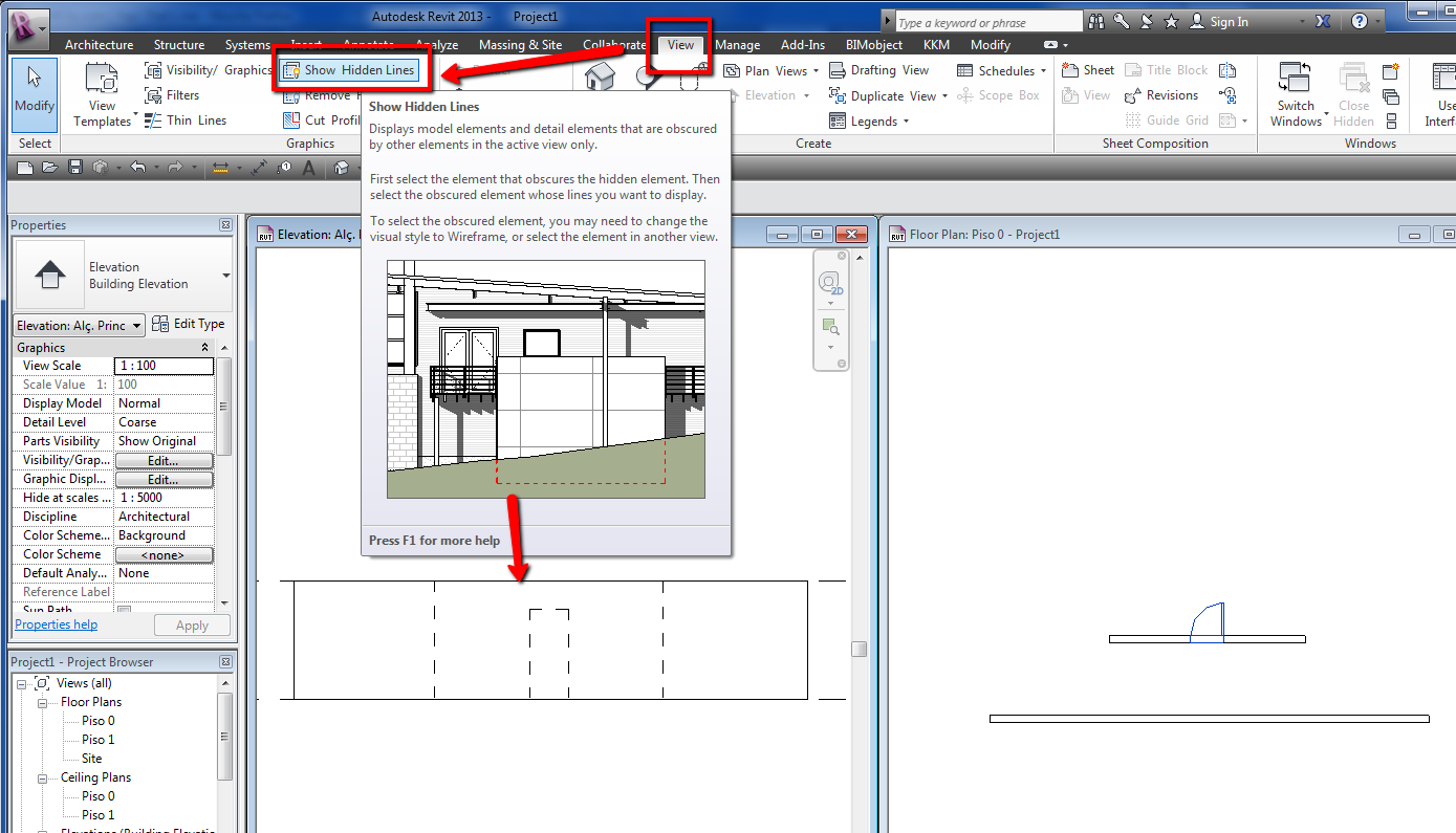

use the "Show Hidden Lines" tool

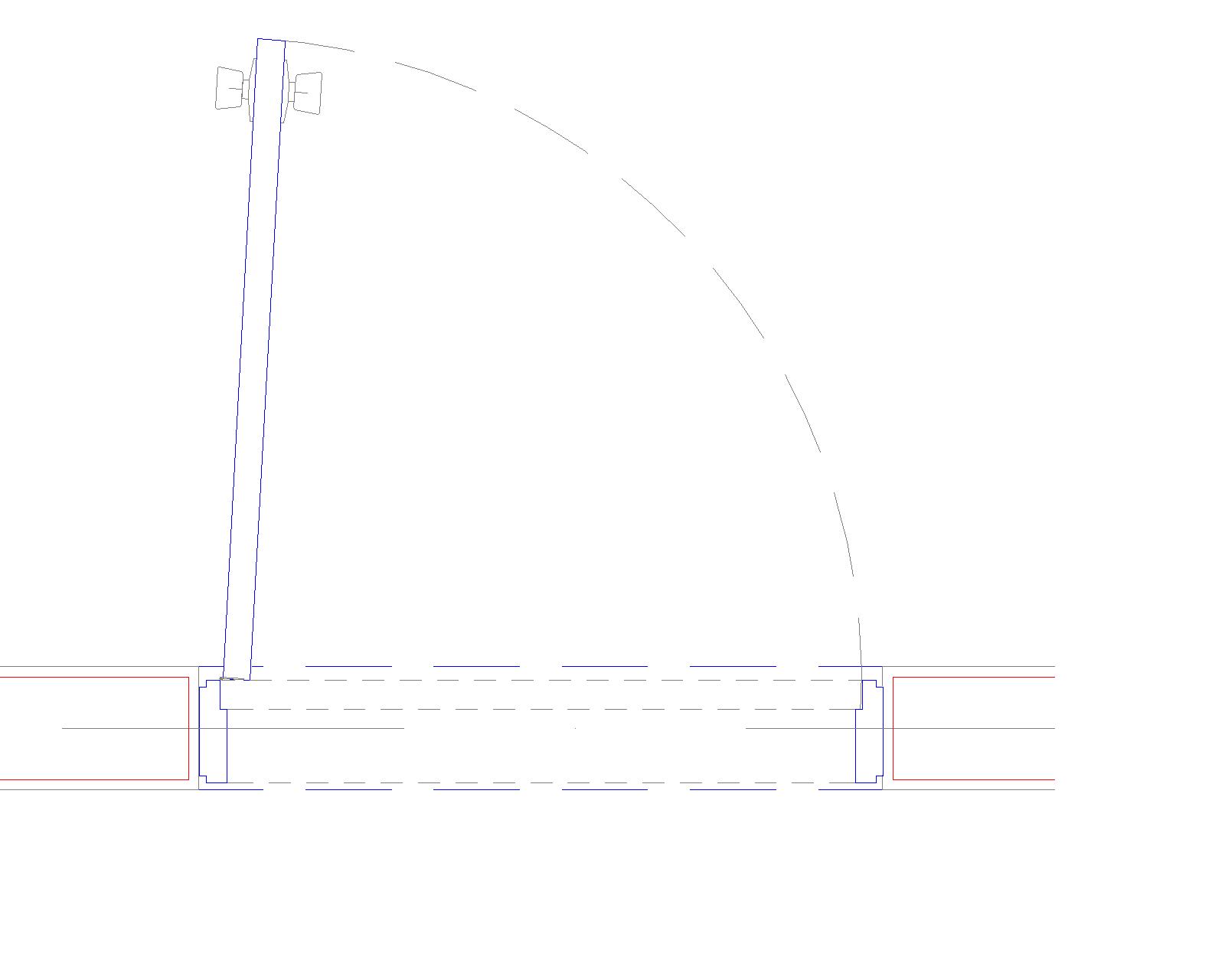

But I think I didn't explain my self properly, so having a pic worth tousand words, here it is what I need, of course this is CAD drawing but shows the standard office representation...

Ohhh I see... you have to edit that door family and create those hidden symbolic lines like you want.
