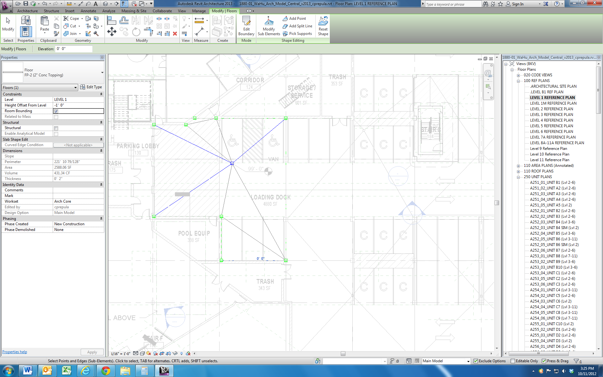

using Revit 2013. I am trying to model the garage floor with drains and appropriate floor slopes. When modifying the sub elements to get the elevations accurate the program automatically assumes all edges of the area are at the same level. I want to show for slope lines, not lines to all corners. How can I make the floor slope based only on the outside edge of the floor?

A little confused... You can change each line / edge elevation or each point elevation, if this is what you want...

The issue is that i Want to control what lines show an edge sloping towards the drain. If I specify heights of specific points and lines, it draws in mulitple lines where is believes a new slope would be.
