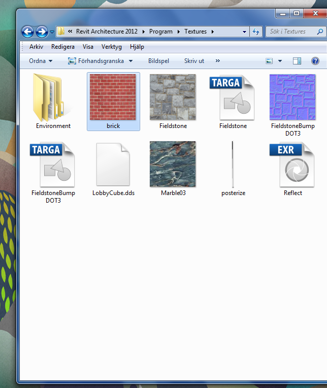

Thu, Oct 11, 2012 at 12:54:56 PM | DevonK
Lolflakes
Joined: Fri, Jan 27, 2012
15 Posts
Quoting DevonK from 2012-10-11 12:47:33
You can go into the materials library on your computers hard drive in the programfiles/RevitA or MEP or S
Is this the correct place to put the texture image? How do I then add it to my wall in Revit?
http://www.ladda-upp.com/bilder-a/revit-82.png
Edited on: Thu, Oct 11, 2012 at 2:56:03 PM
Thu, Oct 11, 2012 at 1:47:08 PM | Adding new materials to my walls?
Joined: Tue, May 22, 2007
5921 Posts
4 Stars: 205 Votes
Create different folders to different categories material like "Concrete", "Wood", Bricks" and so on...
In this way you can create your own library....
