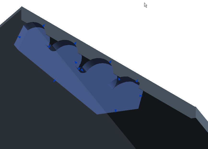

I can extend the fascia board beyond the roof simply dragging it but I can not change type of mitter or customize the the end of it

Is there any way to use the void coomond  for the fascias in the project so I can shape the ends as I wish. I am trying but it didnt work
Tue, Oct 9, 2012 at 1:57:09 PM | Custom barge board/ fascia end profile
Follow Robin's process shown in the first link below.  That should work.  You have to cut the geometry before you close the family.

No ... because you can copy the void sketch from workplane to workplane.

It seems I have problem with setting the workplane on the fascia surface, I have to choose generic family  for void and  wall plane as working plane. whatever I do I can not select fascia plane as work plane somehow.  then I had set  start and end of the extrusion based on overhang size. later somehow if i decide to change roof overhang  size it will be a  very time consuming process I guess.
Wed, Oct 10, 2012 at 7:10:21 AM | Custom barge board/ fascia end profile
#12
First, this is an in-place family and you set it to roof.
After you start the in-place, then pick your work plane before any sketching.
The extrusion depth only has to be as deep or just a little deeper than your facia.
Before finishing the in-place family but after finishing the void extrusion, you choose what it is to cut and you pick the facia, not the roof.

I have figured out finally.
