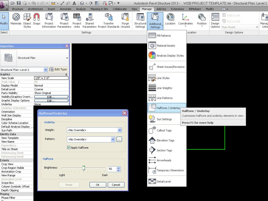

I am trying to add an image, and it's not working.
