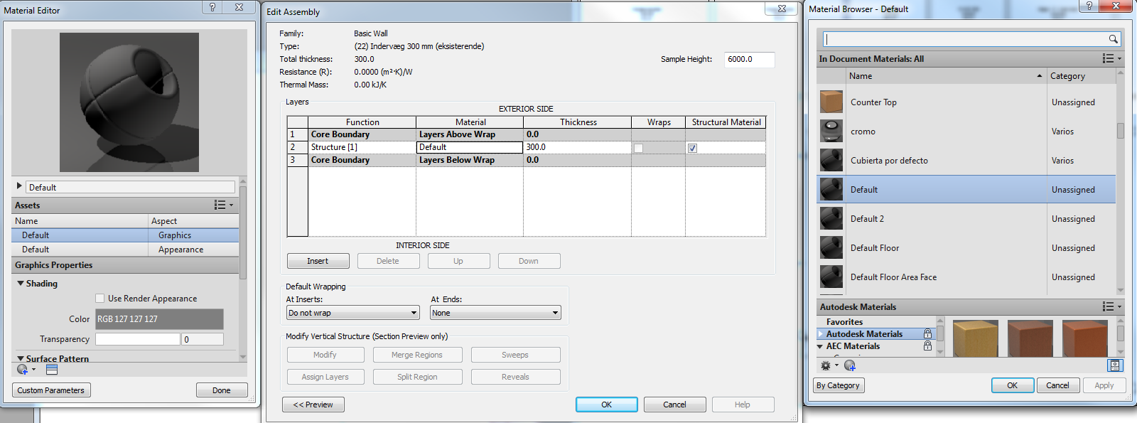

It's the first time, that i've had this kind of problem ind revit. I really don't know, if i've pushed some buttons, which have resulted in this problem. And now to the problem:
When I, as an example, select a wall, and I want to edit it, i push:
1. Edit type
2. Construction, Structure, I push Edit
3. Then I like to select anorther material, and here's the problem. It takes several minutes before it comes up with my material liberary. It has never done this before. And it happens everytime, when I like to change a materiale under a construction-type.
