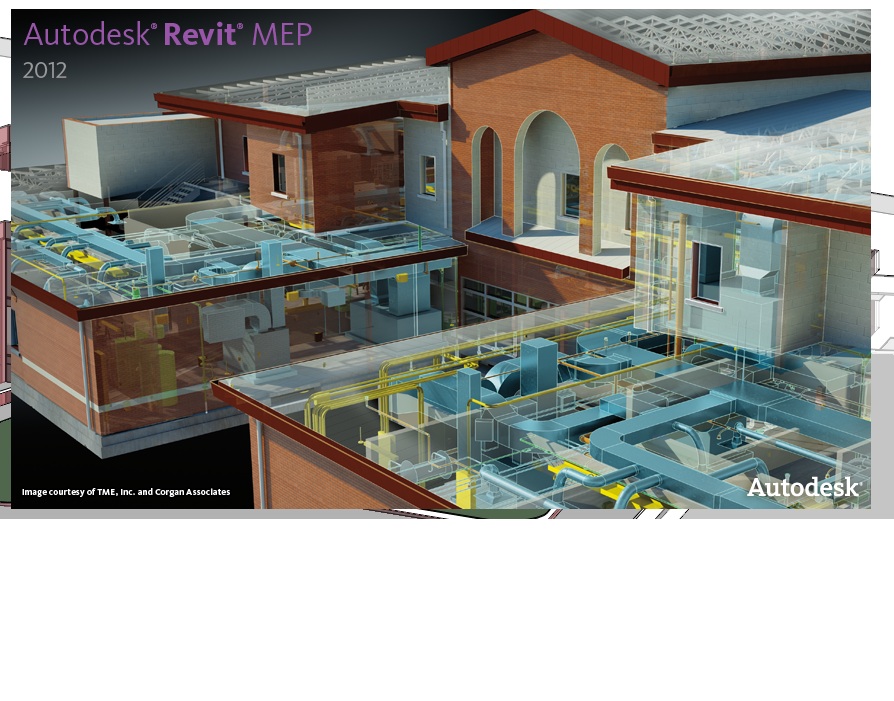

Excelent question, Revit promotes itself showing images like its opening presentation (attachment) but they are impossible to do. I feel as if they were lying to us.

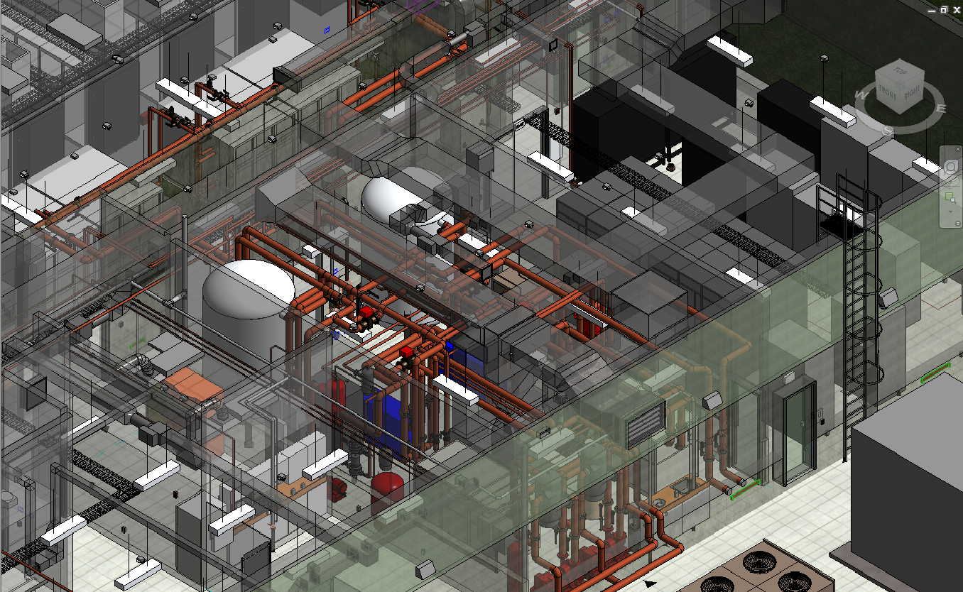

Here's a shot that only took me a few minutes to set up. Ceilings and Roofs are off, Walls and such set to 50%, Ductwork set to 30%. I think this looks great and demonstrates to a client what we're going to provide. I have no idea how I'd get it to render like this without spending days editing materials. I'm playing with it in 3ds MAX but that has the same limitations.

Beautiful !  But i didn't understand. . . . where did you set those 50% and 30%. Is that mep 2013 transparencies? If so, how can I do it in 2012?
Ah! that's a realistic view, not a render. isnt it?

Yes, this is done in 2013. 2012 can do something similar, in Visibility Graphics there's the option to check Ghost Surfaces. This is a straight 50% transparency. In 2013 they provide a slider that lets you set the percentage. Not a huge improvement, but pretty nice if you want something to stand out just a little bit more.
I think I could get this looking even better if I played with the transparency of sub-categories. But then I'd have to play with the Arch model to  add subcategories for interior and exterior walls, or break it into 2 models. There's a ton you can do, but you still can't make a walk-thru that looks like this.
