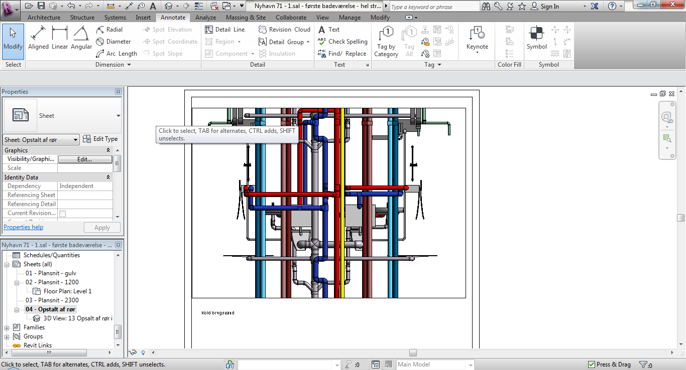

Hey
I've a system with different colored pipes. Can i in any way make a list with these colors and write text behind ?

Do you mean a legend?  Then why not just do that?  Use filled regions.
Legends can be placed on multiple sheets.

Can you make region i 3D views ? I can't do it like normale ? But yes it's legend and ti is the material on the pipes I have change.
Thu, Oct 4, 2012 at 9:44:26 AM | Pipe legends og list
You will be placing this on a sheet - right?  Then why do it in the 3D view?  Just place the legend near / overtop of the view.

Yes it is a sheet, but how do I make the region, I cant press the botton. See picture.

Use a filled region in the actual LEGEND view not on the sheet.

Ohu thank you Smile
