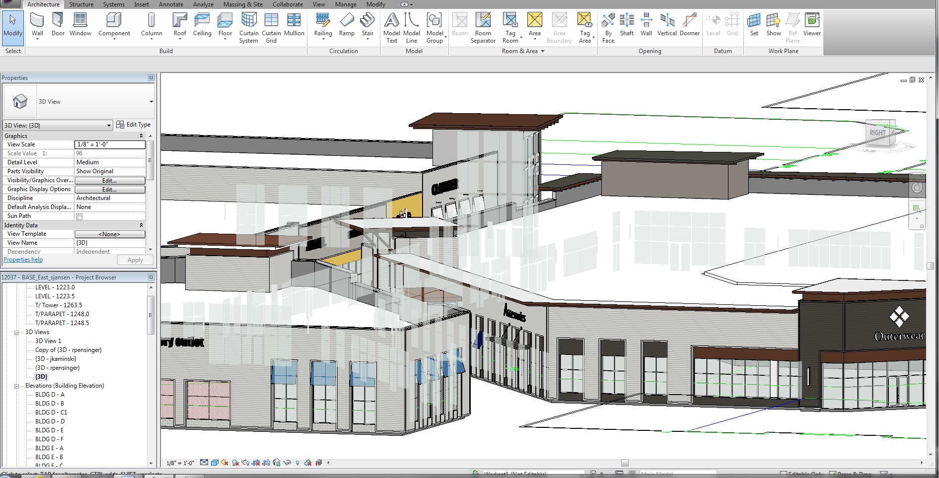

Hi RevitCity!   We are struggling with the glass showing in hidden view where it should be, well, hidden.  Everything else is behaving appropriately, just the glass can be seen.  This anomoly appears to be limited to viewing on the screen, the errant glass does not show up when the image is exported (attached image is a screen shot).  This is happening on all the machines that we have in the office, not limited to one user.  It is also on all projects,  not limited to one model.
Any ideas?  We are running Revit 2013, new machines with a NVIDIA Quadro 2000M video card.  We aren't sure if this problem is a Revit problem or a hardware running Revit problem (ie: video card).
Thanks in advance for any light you might be able to shed on the subject,  your help is very much appreciated.
SJ

turn off hardware acceleration in options, under the R logo.

Update graphic card drivers.

thanks!  turning off the hardware acceleration did the trick, updated my graphics card drivers for good karma.  Smile
sj
