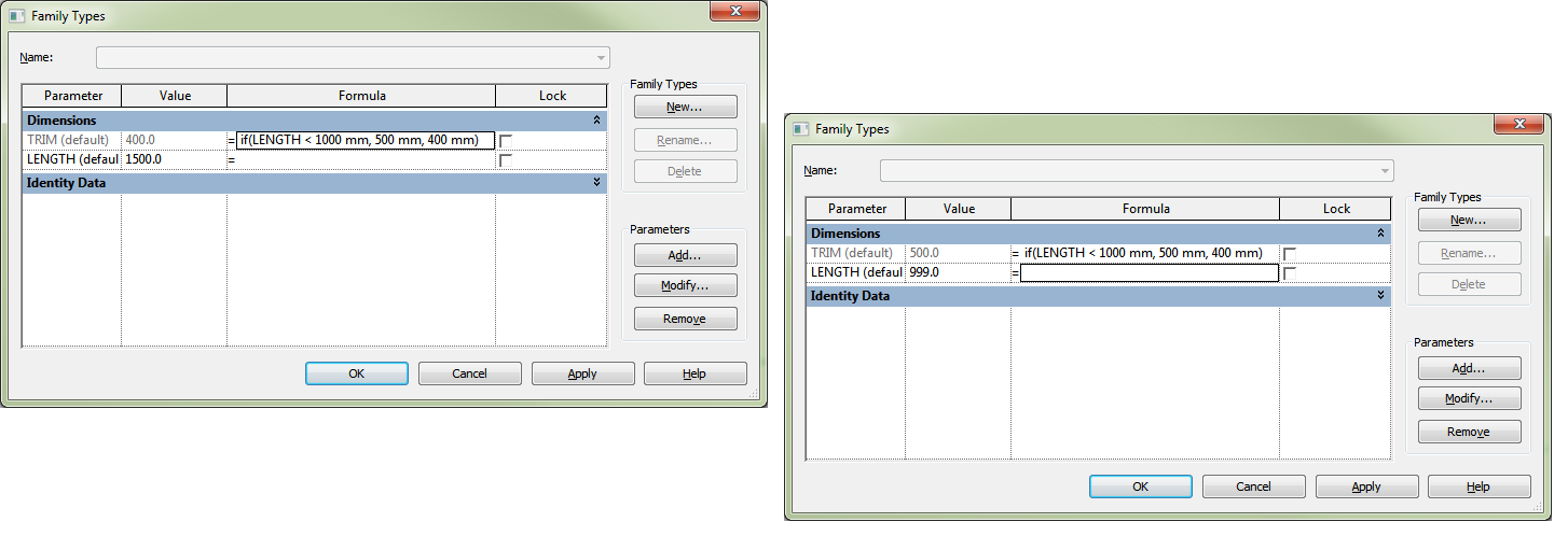

Not sure what the algorythm looks like but when I see your formula I would write it like this for the Trim parameter formula
if (LENGTH < 1000 mm, 500 mm, 400 mm)
This formula equates to 'If the length is less than 1000 make trim 500 else make trim 400."
If this is not exactly what you want it may help you figure it out.
See image.
If Trim is a Yes / No Parameter it gets really simple becasue you can skip the Then, Else.
=IF (LENGTH < 1000)
This equates to: 'If Length is less than 1000 make trim 'Yes' else make trim 'No". No need for the Then or Else aspect.
