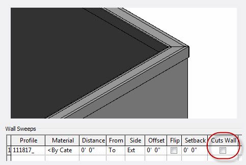

Hi,
I try to create a wall cap family profile, can someone explain to me, why  I always get this command?
"Could not create integral wall sweep for wall instance. Failed to cut wall."
This message always pop up everytime I try to apply this family to the wall in project?
I try to apply this wall cap from wall type parameter > Edit Assembly.
I've tried to search Revit City forum for similar problem, but I got message about "internal server error".
Attached is the profile family I create for wall sweep.
Thank's in advance.

Your profile works correctly if you uncheck "Cuts wall".

WOW! It really work... Hahaha.. I never concern about that tick mark before...
Thank you very much alfmedina! I really appreciate it.. ^_^
