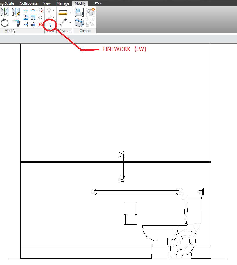

see the attached file, the FRP sweep lines in the interior elevation should be the same or thinner than the grab bars.  I cant seem to get them to go thin.
Tue, Sep 25, 2012 at 2:22:43 PM | sweep line weight in elevation
teafoe5
teafoe5 Avatar
Joined: Fri, Nov 12, 2010
1749 Posts
4 Stars: 47 Votes
Use the linework tool and change them to a thinner line.
Tue, Sep 25, 2012 at 6:52:45 PM | sweep line weight in elevation
Gehrys
Joined: Wed, Jul 4, 2012
5 Posts
Ah, but see how the lines are through the grab bar now.
Wed, Sep 26, 2012 at 7:18:46 AM | sweep line weight in elevation
When you use the linework tool, you will see a node on the end.  Before you continue, grab that node and drag it to where you want.  In this instance, you would do it for both sides.
BTW - make sure you have your object syles set to what you really need.  That is what contols these lines.
Wed, Sep 26, 2012 at 9:02:49 AM | sweep line weight in elevation
Gehrys
5 Posts
I did find that if I set the walls projection lines override to 1 the sweeps look correct.  Is overriding the walls lineweight going to effect somewhere else that i'm not thinking about?
Wed, Sep 26, 2012 at 9:11:34 AM | sweep line weight in elevation
You can set per view in VG if you don't want the object styles, project wide setting.
