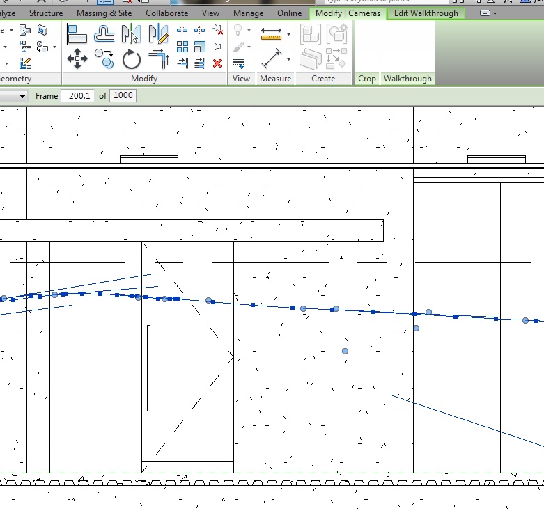

Is there a way to change my key frame levels after the walkthrough is created?
While I am creating my walhthrough I can select the level I want my camera to be placed. After viewing it I noticed that I would get a better result if I could change my camera level for my frames 8 through 12 for example.
How can this be done?

 I also have that same question. But I have done a "work around" for it. Not ideal, but it gets the job done. Insert a building section where your 8 - 12 frames are. Then go and click open your walk thru in the browser. Highlight the cropped area and click edit walk thru. Switch to your building section and you will see the elevation path (in blue see attached jpeg) of your walk thru. At the top click modify/cameras. Then go to your options bar and under controls switch from active camera to path. Then you can select the round blue circles in the path. Move them up or down.
 Hope that helps you out somewhat.

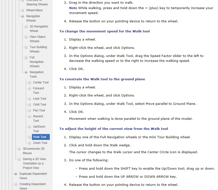

I also found this (see attached)
Walkthrough - 3D orbit/change levels
