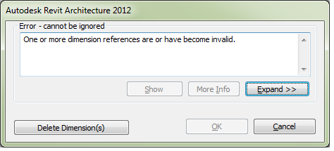

I am hoping one of you whizz kids on here can enlighten me on why I have this problem...! I have an AutoCAD file attached to a revit model I have been documenting for the last 2 months. We made a change to the CAD drawing, which has no attachment whatsover to the REvit model, and now when you open the Revit model there are 26 items which need addressing. Not a problem, EXCEPT..... in Revit's wisdom, you are unable to open the file unless you delete the problems.
Example.... the CAD layout attached to the Revit file is of a site... (and yes I can draft a shitload quicker for 2D site works, so please no comments about how I should be doing 2D line work for site layouts in Revit... it IS slower). Anyway, I changed one line that represents a kerb, not locked to any part of the Revit model.... open the Revit file, am presented with a list of problems that I am not able to do curse about, so open the file and Revit has deleted the floor slab, set downs, footings, dimensions that reference these object...... and so no....!
Why? No idea why, the change as I said had no relationship at all with the REvit file...... niiiiicccceeeeee feature that.

When you say " open the Revit file, am presented with a list of problems" what exactly is that ? Can you provide us a screen capture? Is it prompting you to do a 'coordination review' ?
What is in the REVIT model besides the linked site plan dwg file.
Any and all images will help us trouble shoot your bizarre situation.

Anyway, the Acad file is linked to the model. However, the change I did to the file should not have affected the revit model. Unfortunately I did not take a screen shot of of the message.
I didn't mean that Revit just started deleting objects on its own, when opening the file, the "warning" message came up, before fully opening the file, therefore I was not able to check which objects, or why, they were to be removed/deleted. It gave me two options,
  1. Close the file.
  2. Delete the "references" and dimensions.
Obviously there is an relationship between the Revit and Acad files, and dimensions are made in the drawings, attached to both of these, but..... the change made in the Acad, (site drawing), was not dimensioned, attached, related to any part of the Revit model.
I relocated a line representing a kerb line in the Acad file, and after I opened the Revit file, (agreeing to the deletion of references, etc), it had deleted the building floor slab, which, again, had no relationship, link, attachment at all to the site plan underlay.
There was obviously some sort of issue that was very well caused by me, however, my gripe is, how the hell am I meant to make a decision on whether references, etc are to be removed, without seeing what they are??? I have spoken with other users and they too have had the same issue of the file not being able to be fully opened to see what is going to be deleted and for what reason. Therefore, how are we meant to make sure it does not happen in the future??

Thu, Sep 20, 2012 at 10:34:59 AM | Seriously.... What!!
dgcad
dgcad Avatar
Joined: Thu, Mar 17, 2005
1231 Posts
3.5 Stars: 36 Votes
I linked in a DWG file
used it to create a floor
dimensioned to both the floor and the DWG lines
Saved the revit project
Opened the DWG file
moved and deleted some of the linework
save and close the DWG
Opened the REVIT project and got the attached error.
Summary
Do not use or dimension to linked DWG lines and then change the DWG file.

i think i remember reading that if you want to do this, you want to to put the linked dwg files in a workset before you dimension to them
