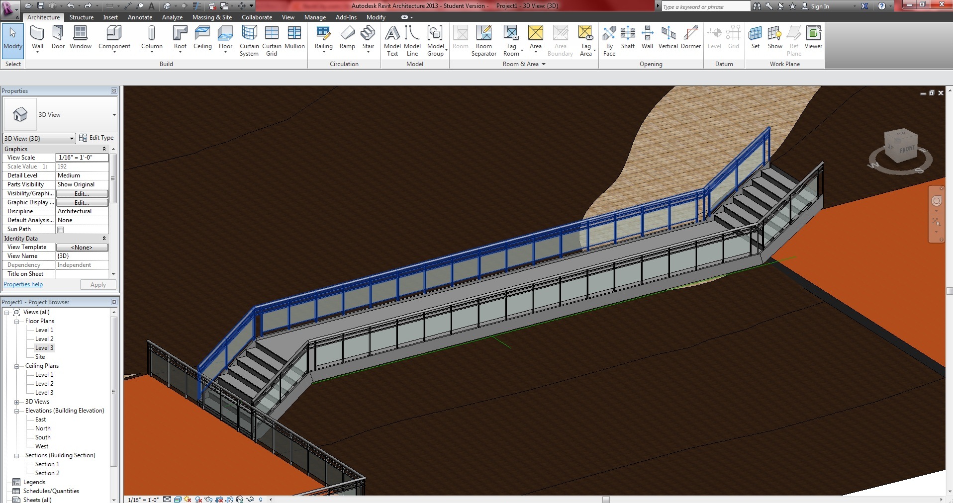

I wanna create 2 runs of stairs that both lead to the same landing. there on opposite sides. How would i go about doing this.
I attached an image. As you can see one of the runs keeps going up. i need that run to go back down and land on the other side towards the floor.

Why not have two seperate stairs one on each end that meet at the landing?

2013, right? just MIRROR the first landing.
