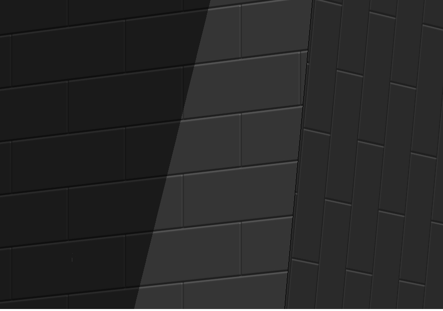

Hey Everybody,  I'm generating a rendering for our firm and I'm having a slight issue at the corner of an element.  I have the same texture on both faces at the corner but for some reason the texture is vertical on one face and horizontal on the other (see attached picture).  Hopefully there is some simple solution to this I'm just not aware of!  Thanks for the help!
Mon, Sep 17, 2012 at 10:43:20 AM | Texture Mapping at the Corner
You will need a view that is normal to this face, then tab select one of your lines in the model hatch and rotate it.
