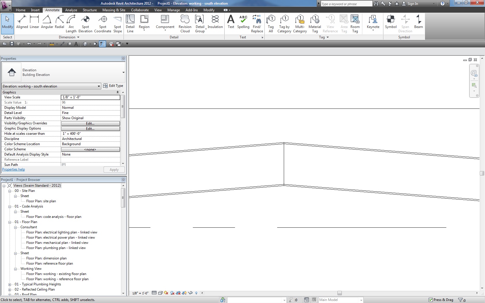

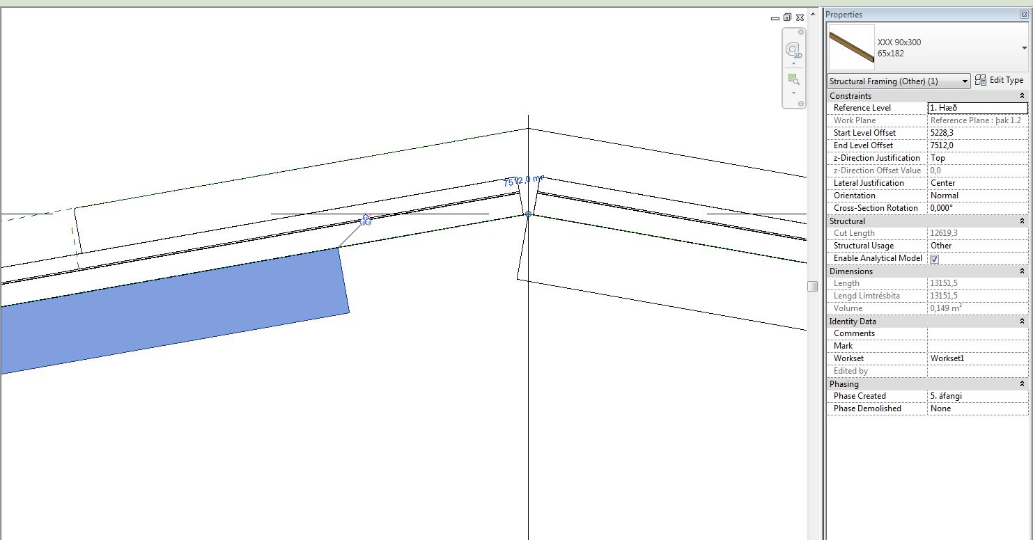

I am trying to connect these beams in the ridge of the building, they are paraleal but wont join in the top.
Does anyone have a quick fix for this?

If you mirror one beam to the opposite side they should miter and join.  Otherwise try using the beam connection join function under modify.
