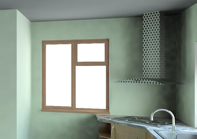

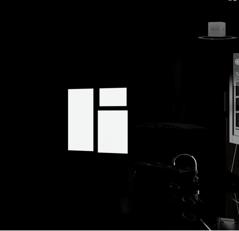

I am new to Revit and am having an issue where Ray Tracing an interior shows up black, where as if I render the same view it renders the sun and interior lights correctly?
I have set the graphic and render settings to the same - interior sun & artificial and anything else I can think of but it's just not doing it.
Am I missing something or is this a bug?
Also while I'm at it - can anyone help me with the shadows as shown in the rendered pic - it just makes the walls look dirty, is there a setting or something I can adjust to fix that up?

Hi! have you tried changing the sun setting while being in Ray Trace view different thing if you change it when being in realistic.

Hi - I hadn't done that - I managed to get it working now, thanks for the tip.
I found also that the sun works better when the background is set to sky and the ground color is something lighter than the default grey.
