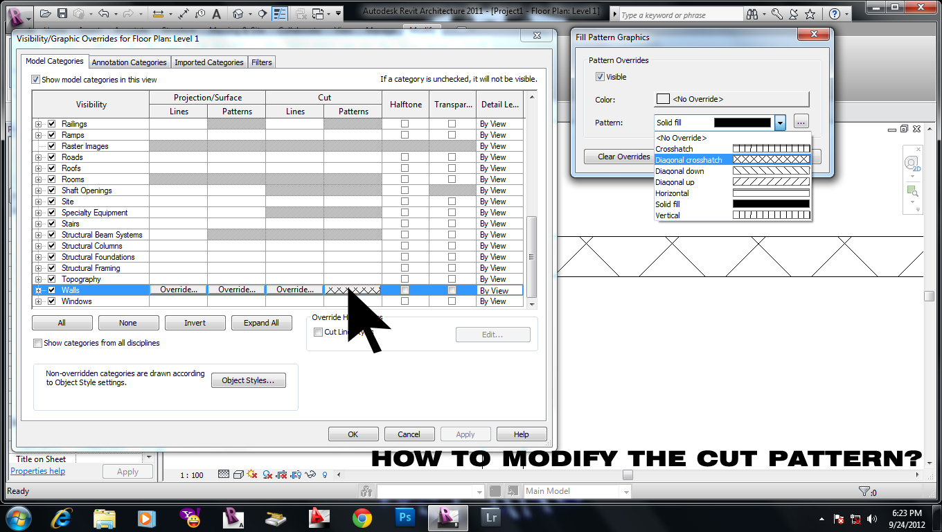

How to modify the cut pattern (ex.inside the wall)

if you want to show the materials in the plans- just show -you can simply ues for the Detail  level : Medium or fine ( the button is near the scale button or in the properties
if you want to spearate : you can click  the button create parts by selecting the wall... it will apear in the modify tab... then all parts of the wall (block-paint ... will be modified  because it is separated.

Medium or fine view settings will show the wall layers according to their cut properties (assuming the wall is cut). And then the materials are tagable according to their material properties, just like your section view.

Mark, I don't understand your issue... You want your walls in plan view like you have i(n your screen shot) in section view?
What do you mean by: " I know only the default but I can't modify." ?
I don't get it...

my problem is'I dont know how to create cut pattern.

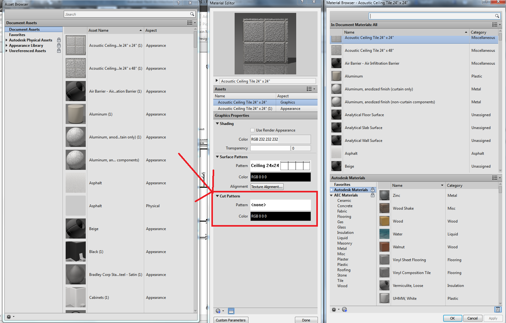

The cut pattern is in the materials editor. See attached pic.  Just change it from "none" to a pattern you want.

Guys Thanks for the reply.My problem is,how to create a new cut pattern?is thier away?
-we have a lot of cut pattern for the wall right but I want to create my own design for the cut pattern if thier is a way. Thanks

ahhhh... you want to create PATTERNS....
here: http://www.revitcity.com/forums.php?action=viewthread&thread_id=8590
another one: http://www.revitcity.com/forums.php?action=viewthread&thread_id=21478
