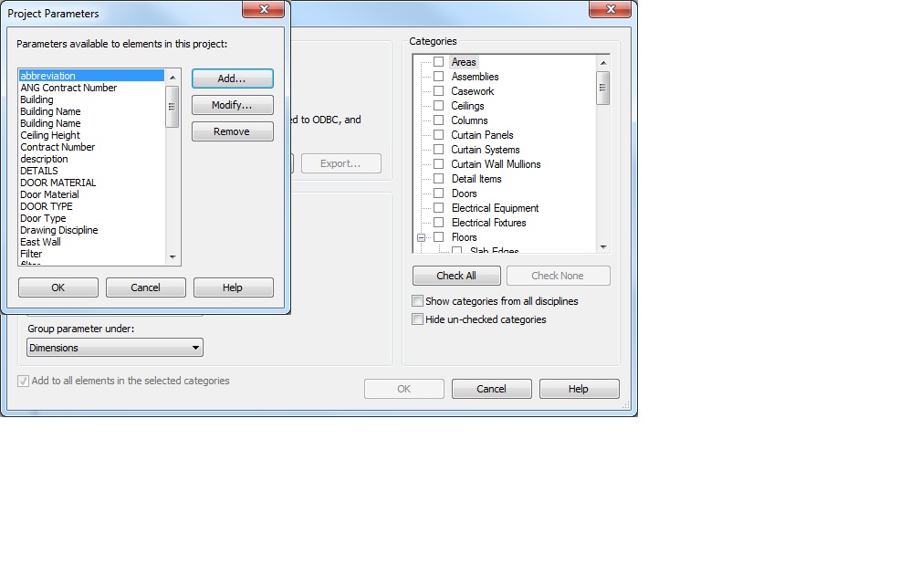

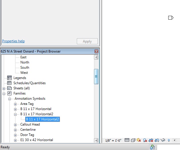

Not sure how to do this.  In the project browser on the left, I see them already listed under familirs/ annotation symbols.  Is this what you're talking about?

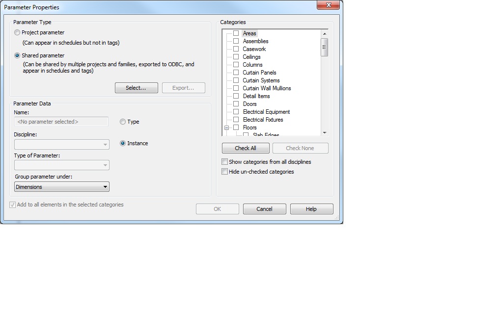

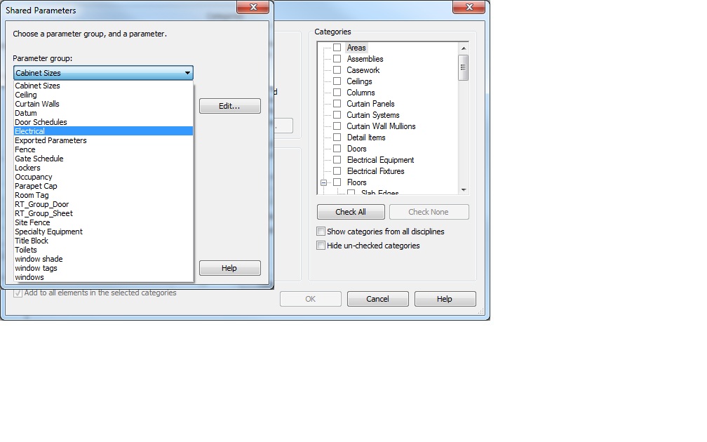

Go to manage - shared parameters - add - check shared parameters - find your shared parameter for the label you made then click ok.  Select under categories either project info. or sheet.  Sheet for per sheet, project info for all sheets you decide.
