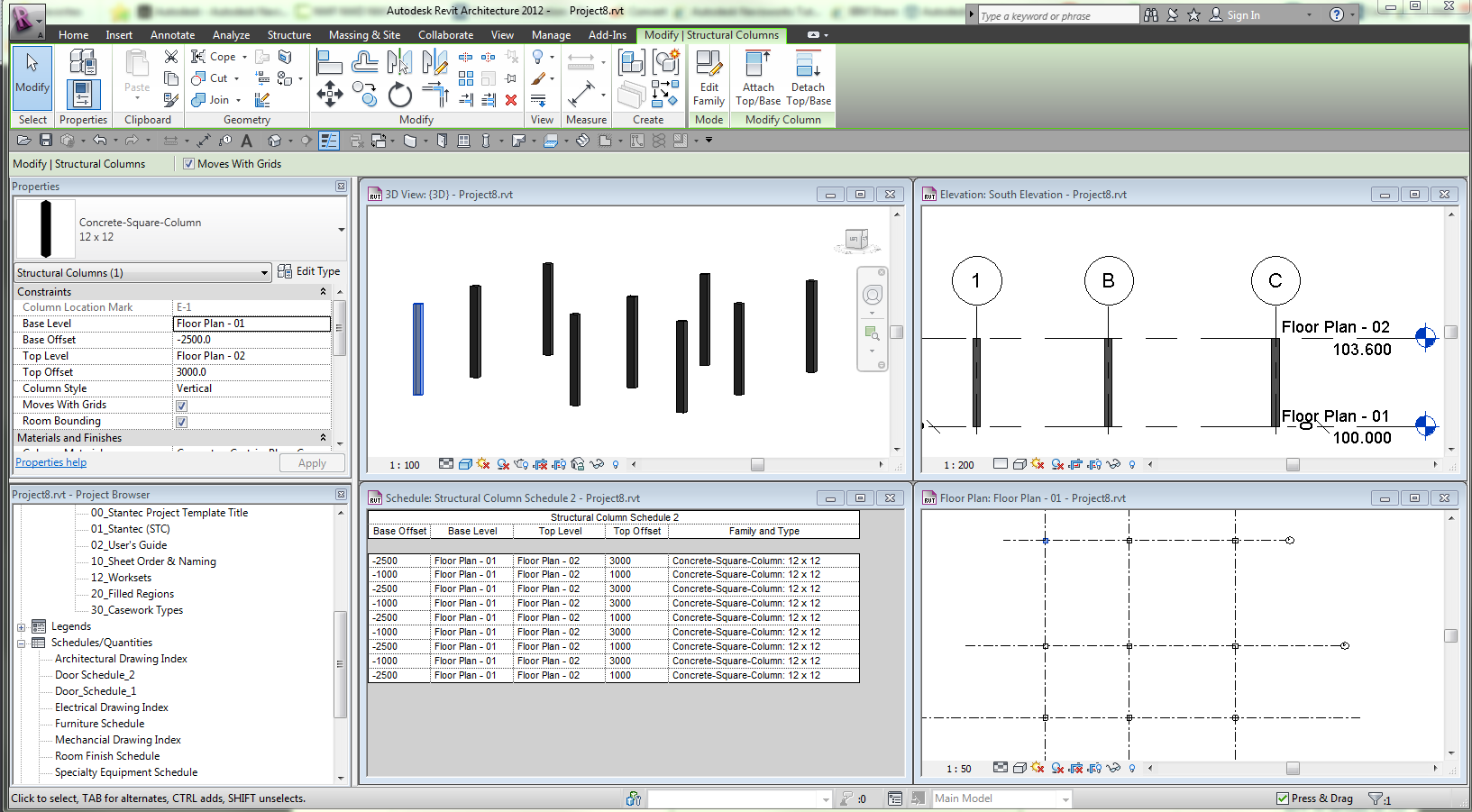

I created a structural column schedule. In this schedule I included the field:
-Top Offset
-Bottom Offset
As well as other fields (but I’m only having issues with only these 2)
Issue:
I change the top/bottom offset (ie: bottom to -250mm/ top to 1200mm) through the schedule. I then go to the model and select the column I just changed the top/bottom offset. Check the properties and the offset distances are matching the column schedule, Perfect! BUT, the model does not show the offsets. The model still visually looks like default offset (which is 0mm)
The strange part is... when I change the offset through the property manager the column in the model reflects the change.
My question is:
Why doesn’t the column offset change in the model if I update the information through the schedule?

YIKES !
Strange, I've never tried editing the Top or Base offsets of a column through a quantity schedule but you are 100% correct.
OMG do NOT edit the Base and Top offset of a column through the schedule. Simple to test and I made it do some horrible things.
Major bug.
 Note two things in the image attached.
1. The ignored top and base column offsets from the schedule tot he model.
2. I have clicked on a column in the 3D view and note that it reports top and bottom offsets in the properties palette that is NOT conveyed in the model.
I saved and opend the project twice and there it was unchanged like a poltergeist !!

The question refers to a structural column schedule, not a graphical column schedule.
I tested the original question in Revit 2013 OneBox, and my report is that, yes, the bi-directionality is broken in this case. Changing the offset values from the properties window updates the column and the schedule, but changing the offset values from the schedule does not update the column nor the instance properties !!
