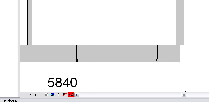

How do i control this? see attached image

could be 2 things: 1: your window family is not right, you might have to edit the family 2: you might need to adjust your view range and get the cut plane through the window (I think this will be the problem) HTH

this problem occures with every window i insert,also the standard windows that ships with revit. in 3d view everything is ok. i'v checked the view properties , and cutplane is at 1200mm. When sill height is set to 0mm, it displays correct in plan view. Pedersen
