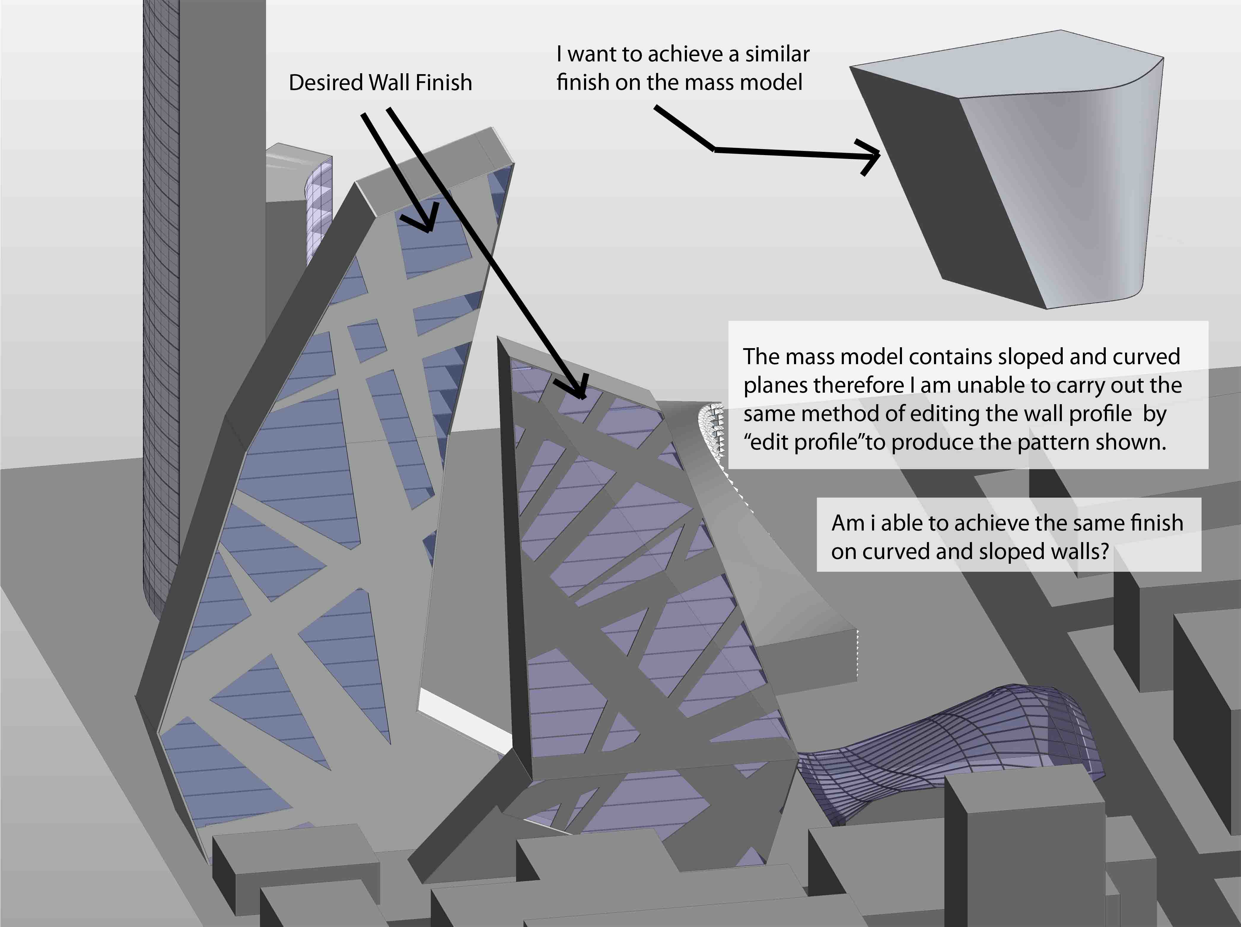

I am wanting to edit wall profiles which were created using make face from a mass model. I am not given the capability of altering the wall profile by “edit profile” because the walls themselves are standing slightly sloped and curved. What would be the best solution to carry out such alterations to a slightly sloped and curved walls?
I have attached images of the Walls and edit profile pattern I desire to carry out.
THANKS IN ADVANCE! :D

Create those "HOLES" in your MASS then your walls will update like you want.

Thanks for the reply Typhoon,
I began to create holes in my mass but noticed the voided created would (no matter how precise) cut slightly into my internal mass area? Since it is an external façade, I not not want the internal area to be affected, any idea?

Apply the same method for voids as for windows in curved surfaces, see the thread you inquired about how to make windows. Just convert the window masss to a void instead.
