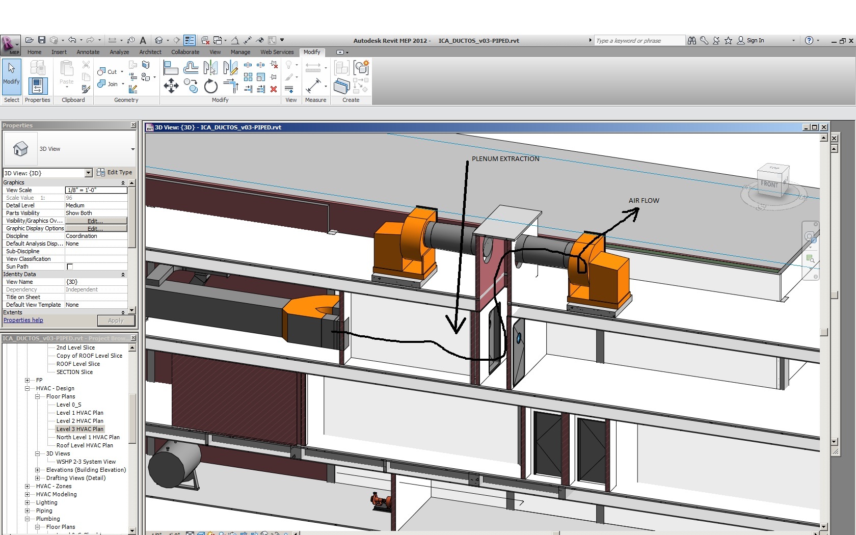

Hi, can anyone tell me how can I make my exhoust system (supply too) to work in the case when the architecture itself IS part of the path of the airflow. I'm talking about the case of "plenums", those little rooms for filters, through which the air passes, without being a duct actualy. I have been thinking of an "in place component" with no objects but only the connectors. Would it work?

You might try using sections of duct in the plenum spaces and then hiding them in the view. The system remains intact if you do this (you can select one part of the system and tab until the entire system is selected, including the parts on the other side of the hidden duct) so I believe you shouldn't lose any information on either side of the hidden elements.
