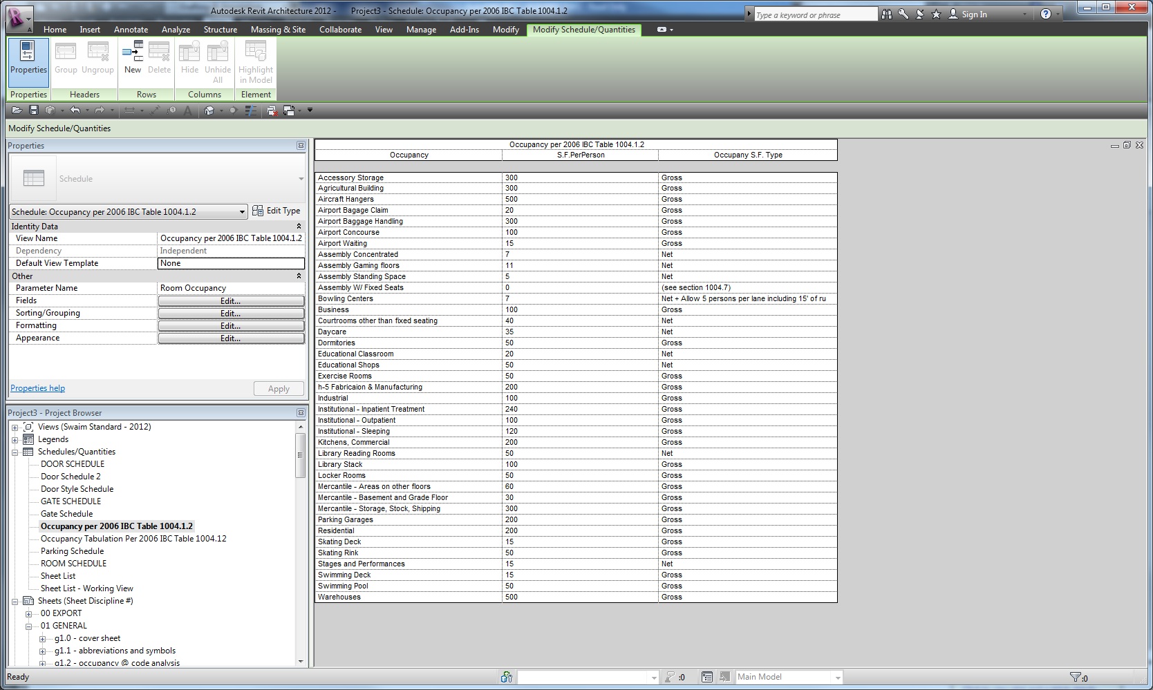

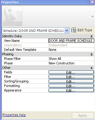

Wed, Sep 12, 2012 at 11:03:22 AM | Unable to Duplicate Schedule
You mean it doesn't look like this?

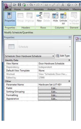

Right. It looks liek this. (hopefully I attached image properly - have never posted an image here...)
I did not create the schedule so I am not sure how this came to be. Thanks for any help!

trying to post image again...

You created your schedule off of a key frame instead of schedule building components.
That schedule style is for building a schedule that will feed into another schedule.  Example an occupancy tabulation.

Thanks everyone! Not sure why it was set up this way, but I ended up just copying the Key Schedule onto two sheets and just dragging one column off the page...  Rather than trying to remake this as a real schedule. Deadline today!

you can always create another schedule as a key frame and filter what you need for each sheet.
