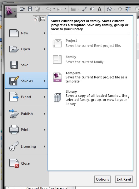

thank you, i Have tryed that, attached image is what i see. i go save as. then it gives ne four options to save in, but projects & families are greyd out. doesnt seem to work for me.

Something is corrupted.
