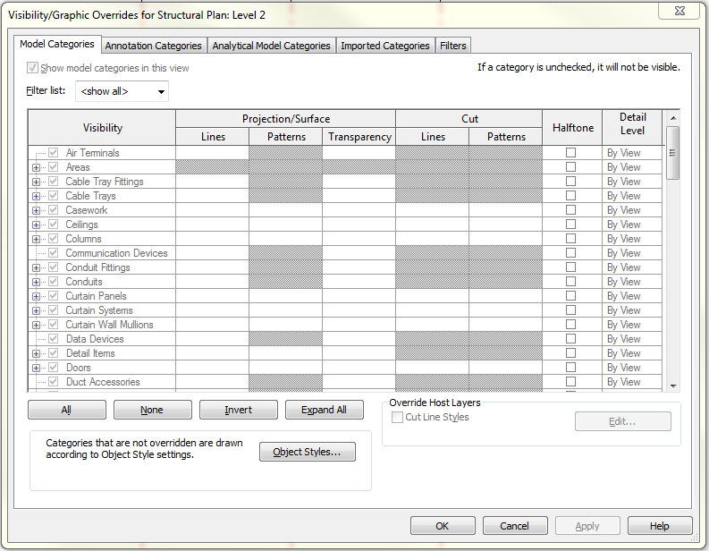

Forums >> Revit Building >> Technical Support >> Visibility Graphics/Overrides COMPLETELY grayed out. Revit Structure 2013.
Thu, Sep 6, 2012 at 4:13:25 PM | Visibility Graphics/Overrides COMPLETELY grayed out. Revit Structure 2013.

I don't know what I could have done to cause this and restarts haven't helped.  How can I get my overrides back?

Do you have a view template applied? That'll gray out Visibility Graphics/Overrides.

that was it.  Thank you!

So how then do you not apply view templates?

Look at the options available when you apply a view template.
