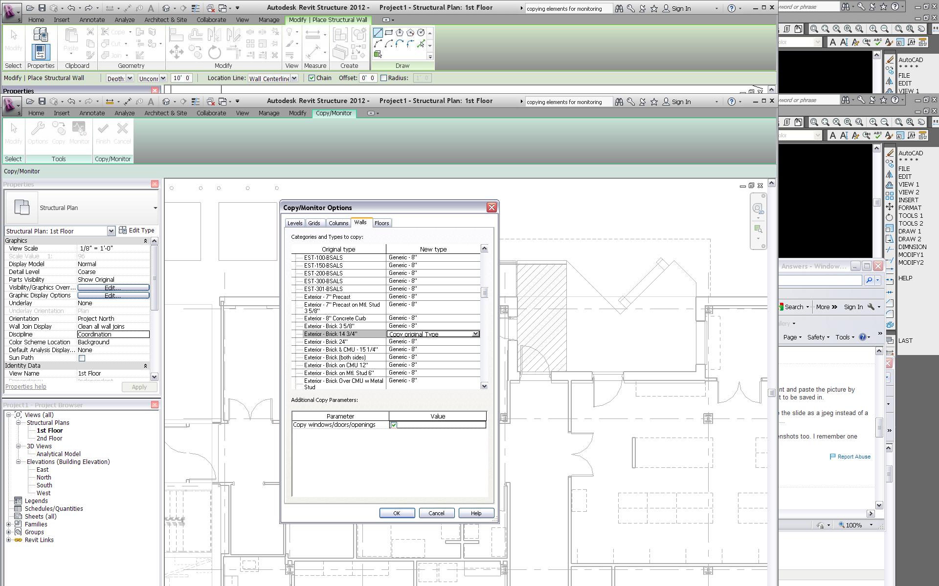

Copy/Monitor Parameters for Walls
Before selecting walls to copy for monitoring, specify the following parameter value on the Copy/Monitor Options dialog. See Specifying Options for Copy/Monitor and Copying Elements for Monitoring.

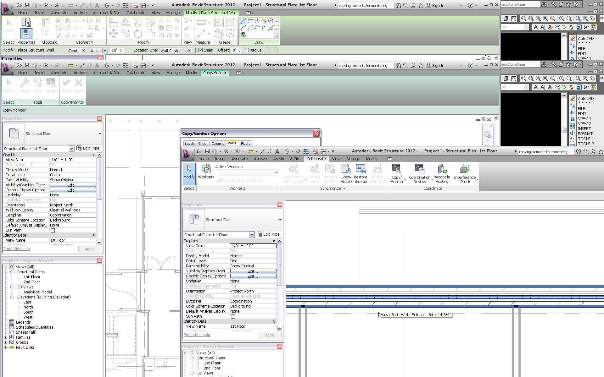

OK - so I CM the exterior brick/stud walls from the architect.  I told it to use their wall type.  Now the walls will not show up if I have the discipline set to structural on the view I am on.  Is it OK to always have the discipline set to architect or coordination all the time on every view?

OMG - I just cut a section thru my C/M wall and it put it in backwards.  The brick is on the inside of the building.
How did this happen?

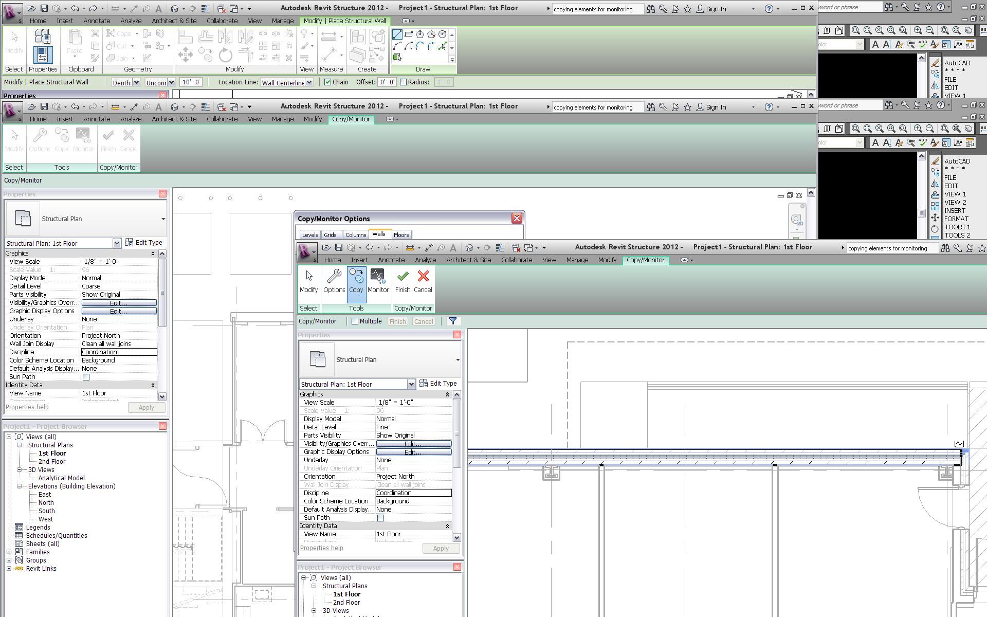

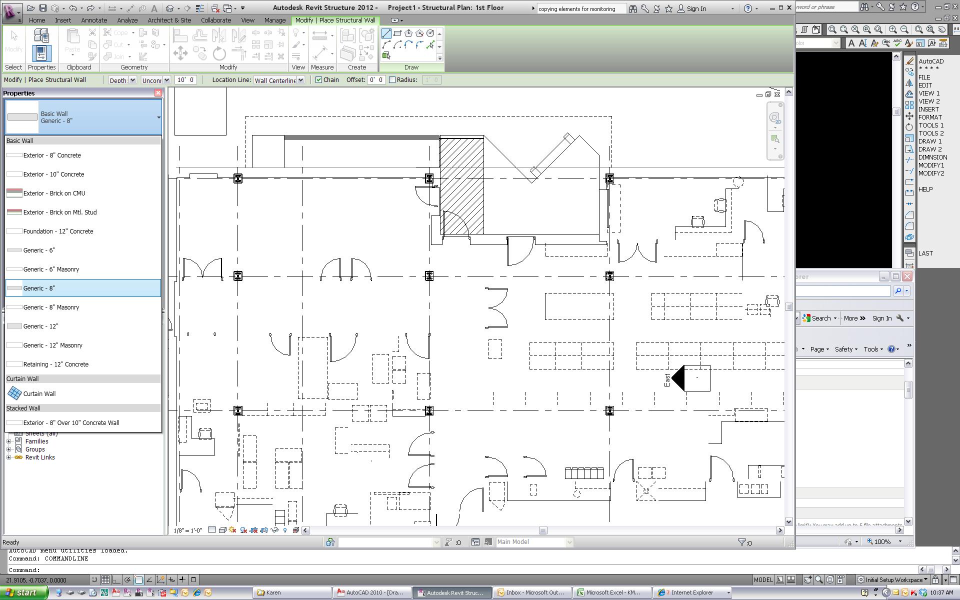

I told it to use theirs and I did not have that type in my file.
Below are my steps (maybe something is wrong)
Yeesh - Where is My Cad
Copy/Monitor walls
