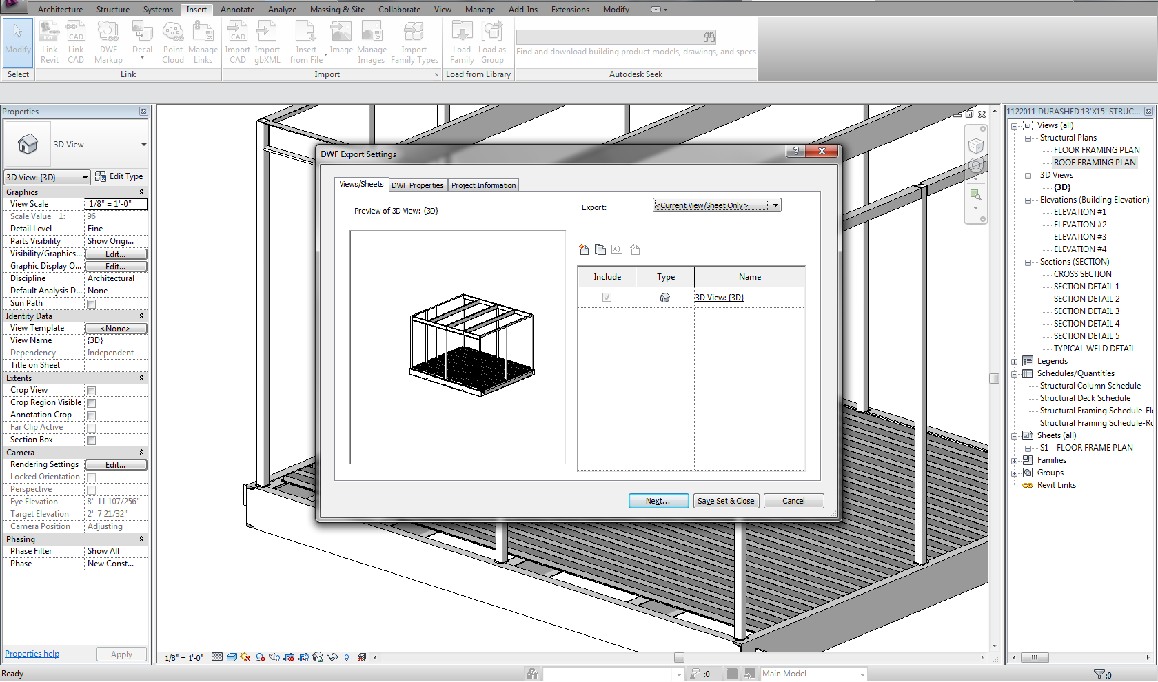

I have a job that I need to export a finished model in a 3d form that cant then be edited or have any info extrapolated from it, so it can be used in another program.  I have the list of file types that Revit can export to listed below.  I know some of them, but I dont know all of them and offhand dont know of any of those that meet the criteria above.
I want to create the image, and send it to a 3rd party to use as a 3d background.  This is because they dont have revit and also because the revit files are proprietary and dont want them to have the ability to make changes or copy data from it.

I agree with Hub, anyone you knows what they are doing will find a way to edit the model if they really want to. The most appropriate would be to use a DWF. As long as you only include your 3D view in the export, they wont get any of the drawings or details, only a 3D model.

Goto a 3D view, not a plan or elevation, and export to CAD from there.

In a 3D view export to DWFx. Anyone with windows 7 will be able to open the 3D model without being able to edit it.  If they don't have Win 7 they will need Design Review.

The 3D drawing worked, when done from a 3D view thank you.
