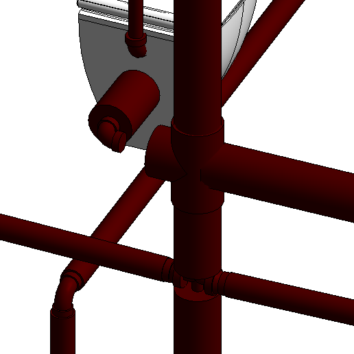

I have just  changed the type on one of the pipesystems i my project, because of colour changing.
But know the elbows and tee becomes small like in the picture. How do I fix it ?
Thanks

Change the type properties of the elbows and tees to match what you changed with your pipe system.
