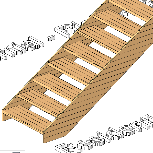

I am having problems creating a 10mm folded plate stair with 50mm concrete treads on top - see attached sketch
If anyone has any suggestions would be much appreciated!

I would create the stair tread 60mm total and use filled regions in the section or detail view to create the separate components.  I believe this is the only way to accomplish what you are looking for.
Wed, Sep 5, 2012 at 1:07:47 PM | Creating Folded steel plate stair with concrete tread
I'm half way with teafoe.  Do the stairs as revit stairs usiing open risers - see attached.  ( You do know that bent plate still have to goto stringers on the side? ) Then do plate seperate as an in-place extrusion created from a section view.
