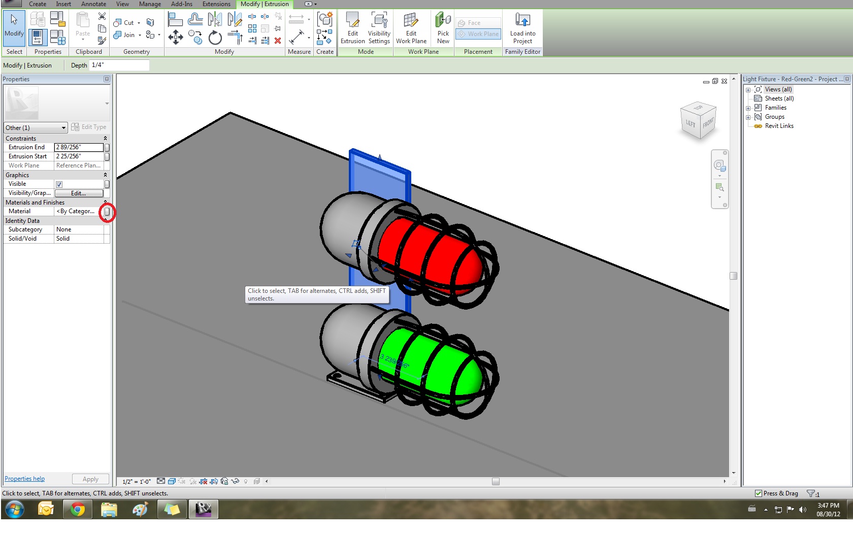

Paulink, it is up to the individual who created the family to make the materials parametric. It sounds like in this case, they do not. You'll have to open the family and edit the different parts. I think it'd be best practice to make the material parametric yourself.
So, select the model and click 'edit family'. Now select the individul part of the model (ie. seat) you'd like to control and look at the properties, does it have a parameter associated with the material? if not, hit the grey square and create a parameter.
Screen shots always help explain your situation so if you're not getting anywhere, please provide a screen shot.
