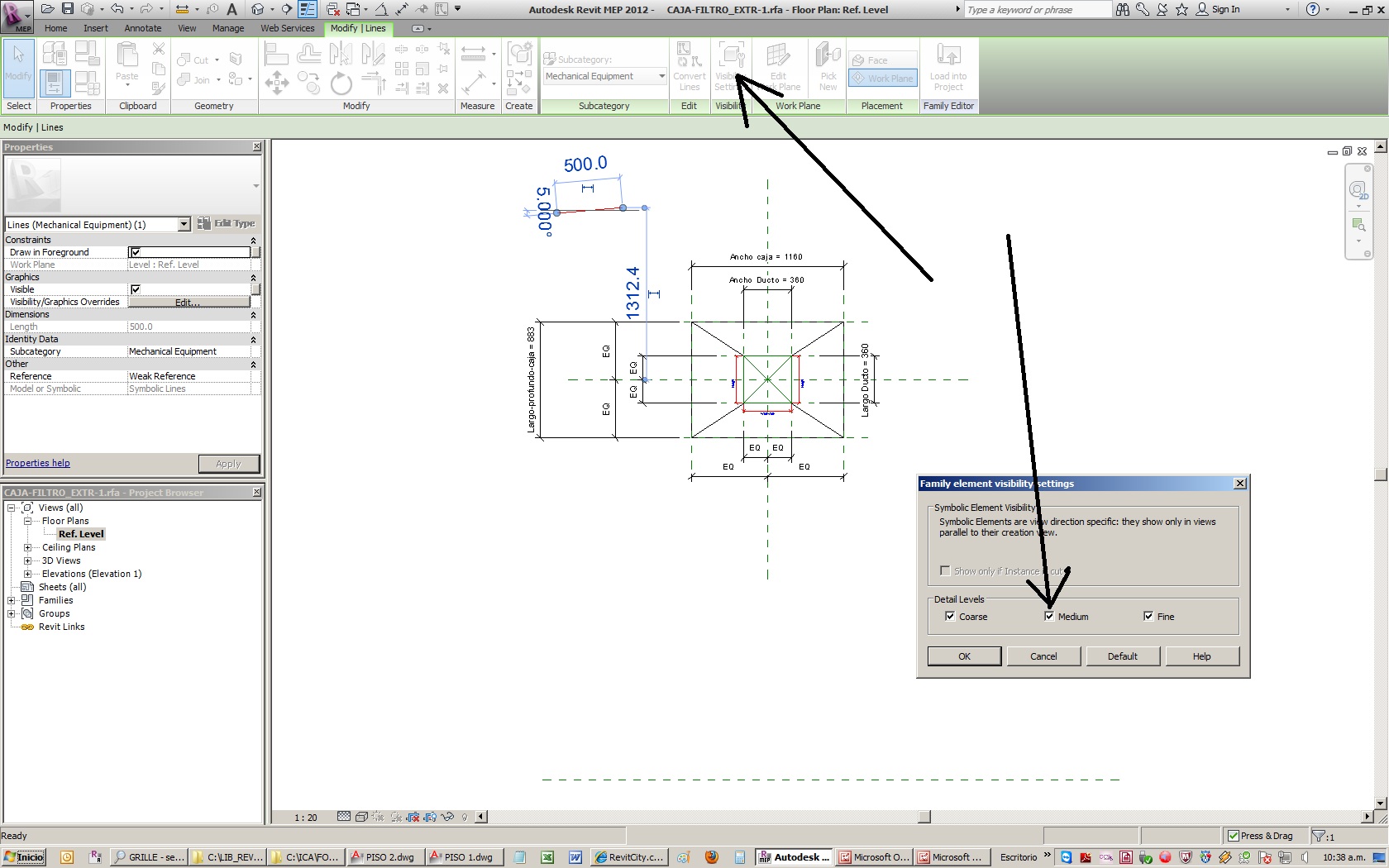

Use the visual settings of the line and check the coarse and medium detail boxes too. Maybe it is that.
