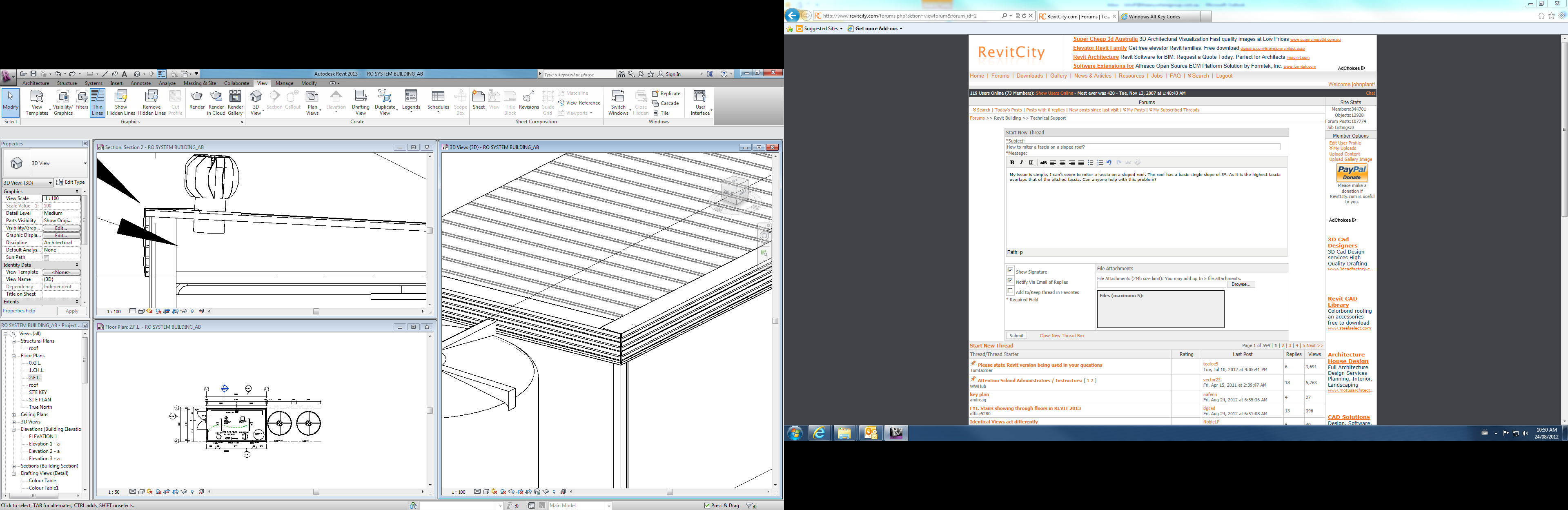

My issue is simple, I can't seem to miter a fascia on a sloped roof. The roof has a basic single slope of 3°. As it is the highest fascia overlaps that of the pitched fascia. Can anyone help with this problem?

If you do the fascia in sequence or pick a fascia and choose add segments, the facia will miter - fist image.  Second image - when done seperately.
