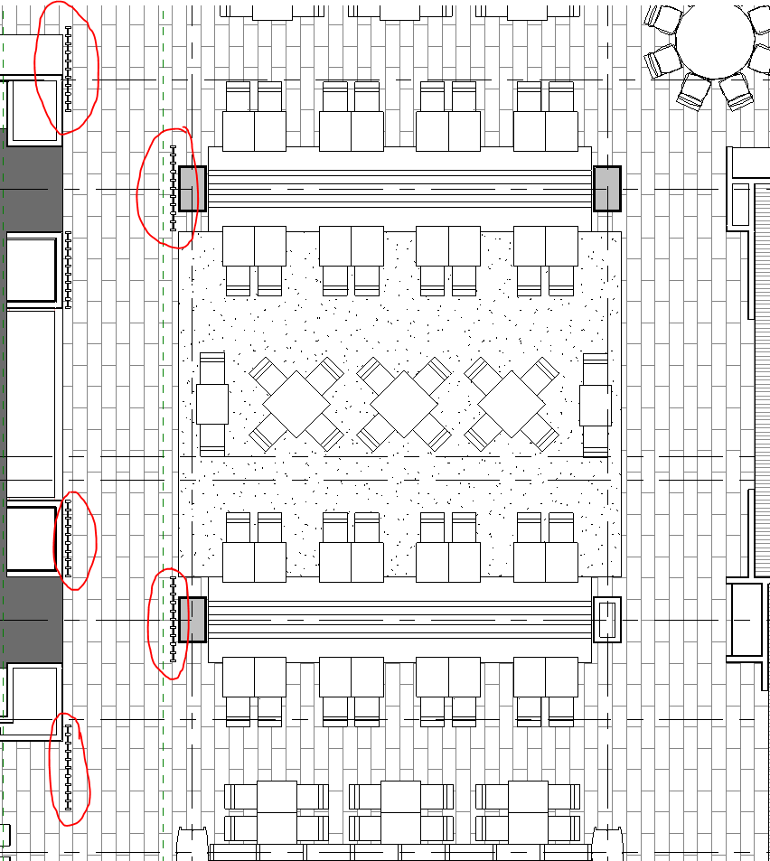

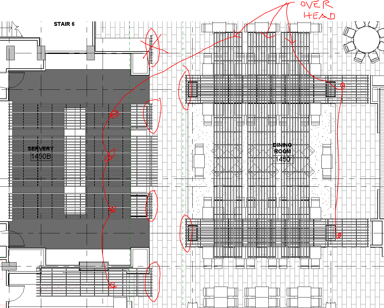

There are two views that show the family differently in each, one has the family "cut" as I would expect, the other shows the family not "cut" i.e. overhead objects show in the plan view.
Both views have the same view templet applied to the view. I have dbl checked everything I can think of to try to discover the difference but I can identify what is different.

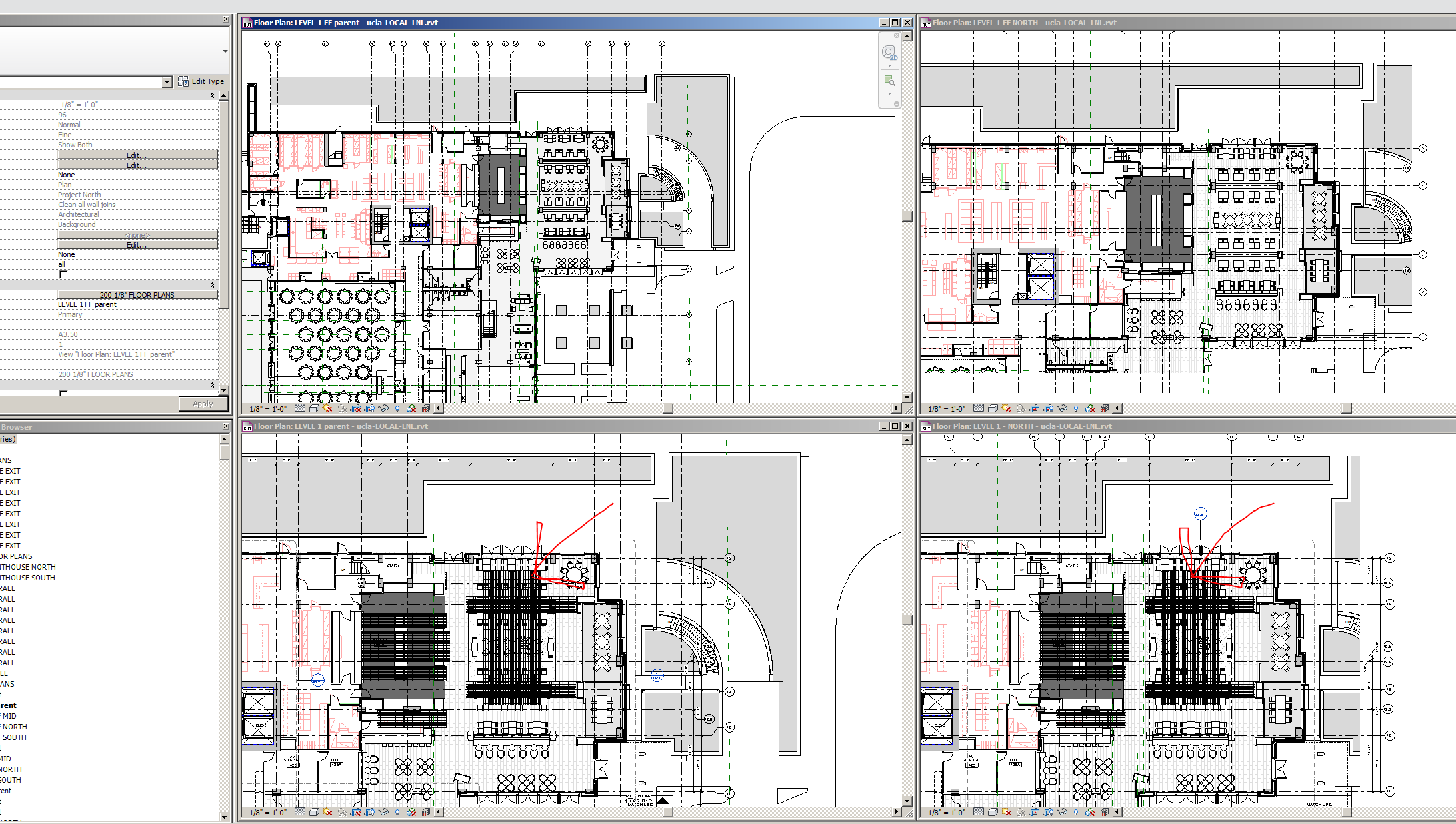

I've attached a screen capture and show an arrow to the overhead objects in the view. The views have dependent views as well thats why I have 4 views up.
Can anyone think of a reason the views act differently?

That is intresting because in the image the generic family IS CUT how did that happen? In most plan views the family is correctly cut. The image I attached shows the one case where it's not cut.
The upper images have the trellis cut at the view depth line the lower images show the entire trellis above the cut line. everything about the two views are identical

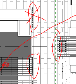

Here are closer views of the same area. you can see the cut object vs the non cut object, (same object in both views each view with the same view templet applied)
Thu, Aug 23, 2012 at 1:17:08 PM | Identical Views act differently
Your not telling us some things.  Why does this one element you have X'd show without the overhead part?
A different family ?
Please verify the cutplane - that may not be included in the view template.

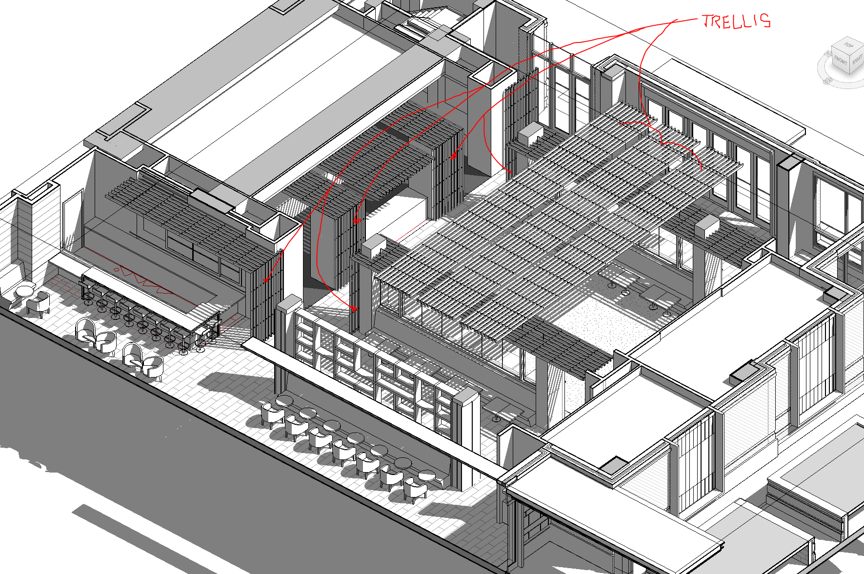

I include a 3D view of the area as well
