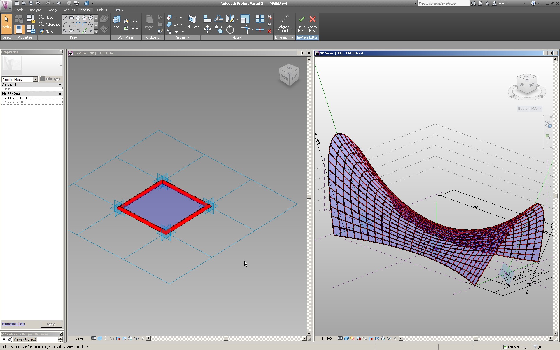

If you need to create "special" mass with "special" curtain wall pattern you have to do that in Conceptual mass and create the curtain panel like you want/need.
Then, when you load into project you don't have to apply "C.W. by face" in Massing and Site....
