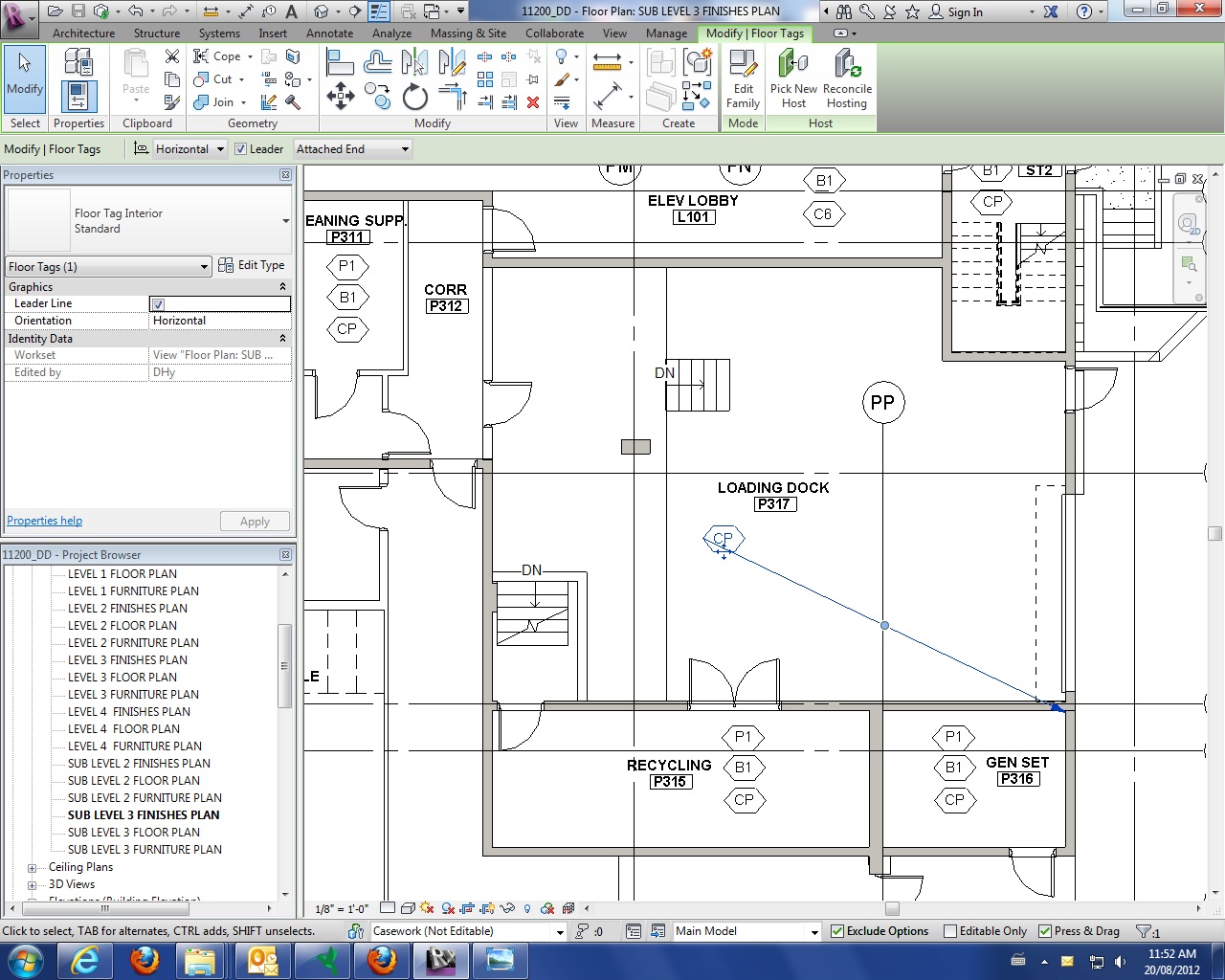

My flooris highlighted in blue. How do I control the arrowhead of my floor tag(at center of the image)  to place it where I want it to?
When I click on my floor tag, it only lets me control the grip in the middle of the leader line, not the arrowhead.

Use free end.

what does "use free end" mean I'm having this problem as well
Wed, Aug 7, 2013 at 9:47:12 AM | Controlling the leader line in a floor tag
Revit's tags automatically goto the center of the edge of floors, ceiling and roofs, it goes to the center of walls vertically or horizontally in plan and it goes to the placement center of families.  This location can not be moved but after placement, you can click on the tag and look at the options bar and switch from attached to free end.  The leader will drop to vertical and you can now place it and the tag anywhere.
You can set the tag to free end before you place it, then you can hover over the object and tab select it ... just change the settings on the option bar.
