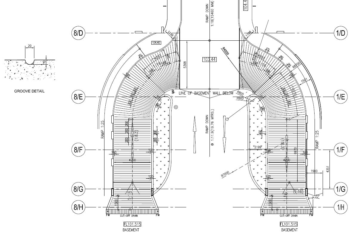

I need to place some grooves on the ramp as shown in the image.And Ramp cannot be cut by void family. How can I achieve this ? Any suggestion would be great help.Thanks.

Use a model-in-place family.  A sweep with the groove in the profile.
