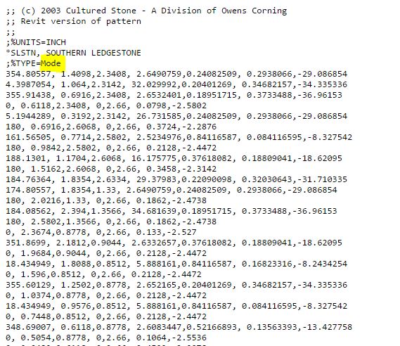

I know this is old but im haveing the same problem with 2014. ive downloaded 3 different stone PAT files one being southernledge stone and try imp0orting them both at drafting and model and it keeps telling me no type patterns found... Ive attacehd the .pat file for reference..

#9
pijpiwo
pijpiwo Avatar
Joined: Fri, Sep 3, 2010
0 Posts
5 Stars: 25 Votes
In the place of mode, type MODEL or DRAFTING. You might need to adjust import scale of the hatch too.
