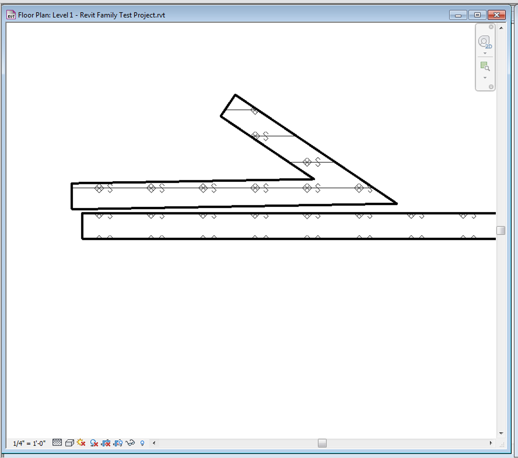

I created a custom wall hatch that I would like to display in the center of the wall, no matter where the wall is positioned...the problem is, when I move the wall around, the hatch pattern stays in place and what is shown changes based on where the wall is.  It is acting as though the hatch is wallpapering the background, and the wall is acting like a rectangular view port into part of the hatch at any given time. I never realized hatches work this way until now...
Please see attached photo. Anyone know how to fix this?

Update...just stumbled across a similar thread: Changing the pattern to "orient with element" changed it.  Perfect.
