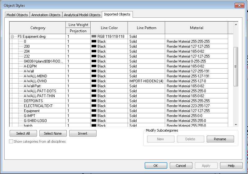

Actually, if you want different materials for different items in your imported CAD, then each item to have a different material MUST be on a unique layer.  This is how you control materials for imports.  Manage tab - object styles - see image.
Also remember that "THE PROJECT RULES".  Once a material is assigned in the project, it has to be changed in the project.
