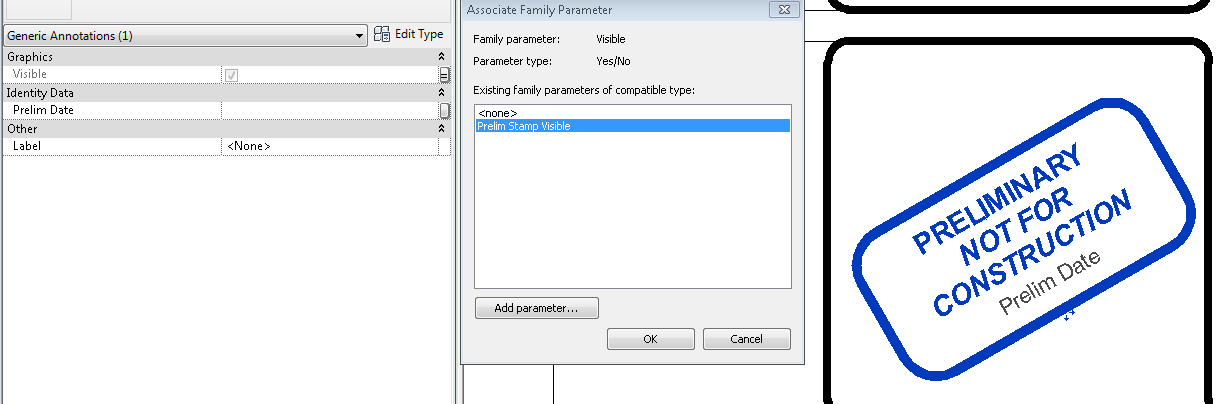

This is a bit of a wishful question, regarding scales in Revit, involving title blocks.
As we know, we can put in a label on a title block and Revit will let us know the scale of the drawings (providing they are the same). How I have mine set-up, I have Scale @A1 - 1:100.I am wondering if it's possible to add a section scale label which calculates the scale at half, so if the document is printed at half-size, automatically it displays the scale for that print size. Example....
Scale @A1 - 1:100
Scale @A3 - 1:200
Which would show up in all drawings, regardless if it's printed at A1 or A3. So is this possible? Or do I have to manually put it in with text?
Tue, Aug 7, 2012 at 7:23:21 AM | Different Scales on Titleblock
No way to do this that I know of....
Why don't you have a "stamp" that you can turn on in the titleblock that says HALF-SIZE PRINT
Tue, Aug 7, 2012 at 7:33:40 AM | Different Scales on Titleblock
Richo
Joined: Sat, Oct 30, 2010
10 Posts
How would you do this stamp?
Tue, Aug 7, 2012 at 8:04:29 AM | Different Scales on Titleblock
We have a not for construction "stamp" in our titleblocks.  I would think you want something similar.
Note that are stamp is cocked so that it stands out.  The visibility of the stamp is set with a parameter.  To set the parameter for printing, pick any instance of the titleblock, then pick select all instances in the project and set the switch.
