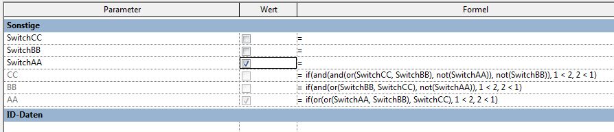

Trying to find a formula for this situation....
AA, BB & CC are parameters
when CC is turned on, BB and AA turns on;
when BB is turned on, AA turns on and CC turns off;
when AA is turned on, BB and CC turns off.

hi! not sure of what i am saying beacuse i am pretty new with revit! Smile i think that your request creates internal conflicts because when CC is turned on it turns on AA wich then turns off CC.. so basically you cannot turn on CC..
what i would do is create three more variables. (on off switches) like this:
SwitchAA
SwitchBB
SwitchCC
AA
BB
CC
and would put these formulas for these:
SwitchAA: if (OR(SwitchBB , SwitchCC), 2<1,1<2 )
SwitchBB: if (OR(SwitchAA , SwitchCC), 2<1,1<2 )
SwitchCC: if (OR(SwitchAA , SwitchBB), 2<1,1<2 )
AA: if(OR(OR(SwitchAA, SwitchBB),SwitchCC),1<2,2<1)
BB: if(AND(OR (SwitchBB, SwitchCC), NOT SwitchAA) ,1<2,2<1)
CC: if(AND(AND(OR(SwitchCC, SwitchBB), NOT SwitchAA),NOT SwitchBB),1<2,2<1)
i did not test it so it might need a few modifications. hope you get what i mean. if you try to explain better what you are trying to achive it might be easier to help... Smile

just tried, it does not work. its a circular reference.. Sad sorry

here we go.. tested and works.. Smile hope it is what you need! Smile

@gebber: I already did that but wanted something which would be automatic like with formulas. Thanx for the reply.
@frifer: ur formula worked like a charm! thanks alot! Smile

i would create it with a single parameter insted of the 6 yes/no boxes. i posted that as solution since it was the request.
so instead of having all the switch variables etc i would use a integer that can be a value between 1 and 3 and based on that change all the other variables.
it avoids having multiple checkboxes on at the same time while only one is actually changeing something because it has a higher priority.
so, if AA BB and CC are just some variables in the model and not the checkboxes:
Switch on number (is an integer between 1 and 3)
AA: if(Switch on number = 1, 2345 mm, 6541 mm)
BB: if(Switch on number = 2, 2645 mm, 1541 mm)
CC: if(Switch on number = 3, 345 mm, 641 mm)
in case of switches its even easier:
Switch:  if(Switch on number = 1,1<2, 2<1)
its easy tu understand, to use, and to implement.
