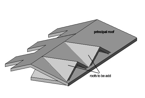

Sounds like Roof by footprint would be better for achieving what your after. Attach a screenshot. You can use the Roof join tool to attach different roof edges to intersecting roof faces...

here i send a screen shot. I've already tried to create (one and both of them) by footprint, but without success. I've also tried to use slope arrows in the principal roof to create a dormer using slice, but with no success. NO idea how to go on....

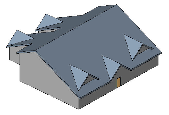

Here's what the roofs look like in the sample

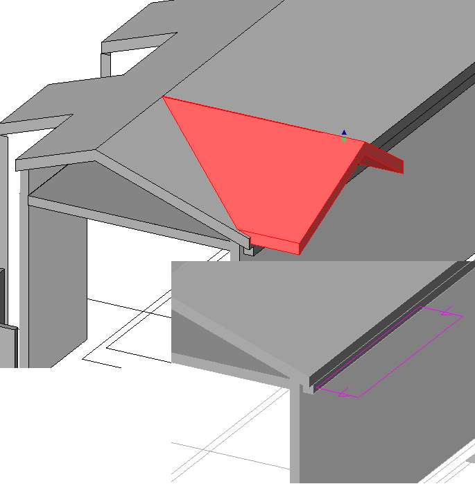

thats right. i step forward. anyway, to make it I had to draw it outside the principal roof, and then join it. anyway I cannot edit neither make an opening to make it as in the earlier screenshot (or the sample you sent). if you check your model and try to edit it, it also doesn't match with 3d representation (see image). any clue??
