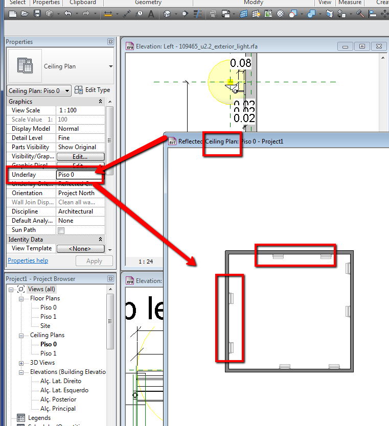

Change the "Underlay" to that level

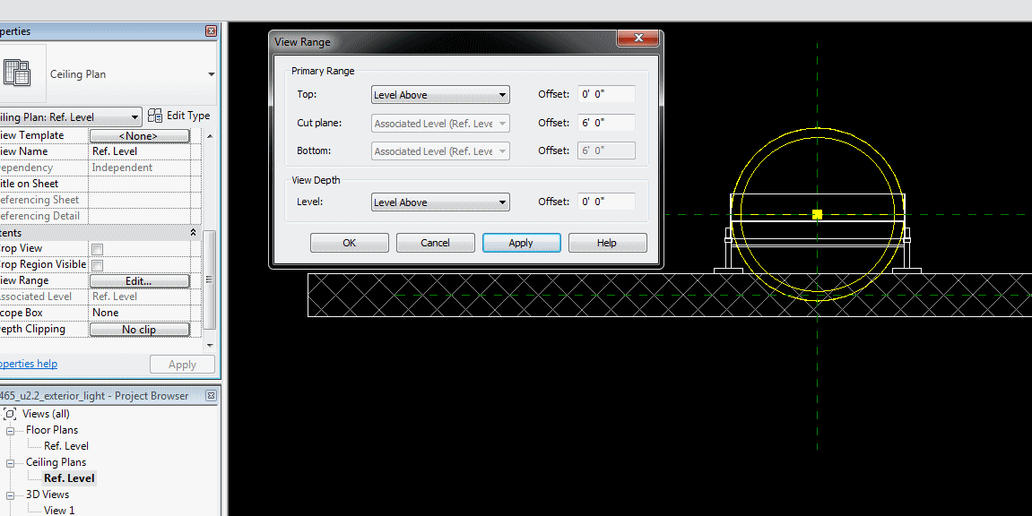

I changed the view range of the Ceiling Plan in the family to 6'-0" and the fixture became visible in this view in the family (see screenshot). Try reloading the family and hopefully it will show up. If not, perhaps you have the family below the level of the cut plane in the RCP-?

Mission accomplished.  I changed the offset on the cut plane in view range.  The first solution would have been good if it didn't also make all my furniture layouts show up too.  Thanks guys!
