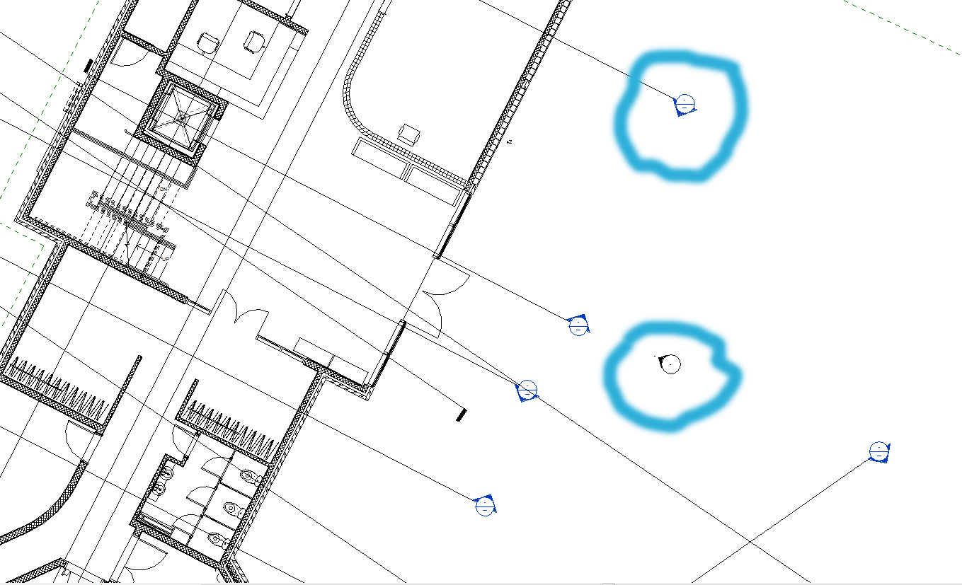

How do I show texts in these?

You have to place the Section/Elevation views on sheets...it will automatically takes the sheet number and detail number.

also, if you change the sheets the views are located on, it will automatically change them for you.  you should never again have to worry about updating your tags.
