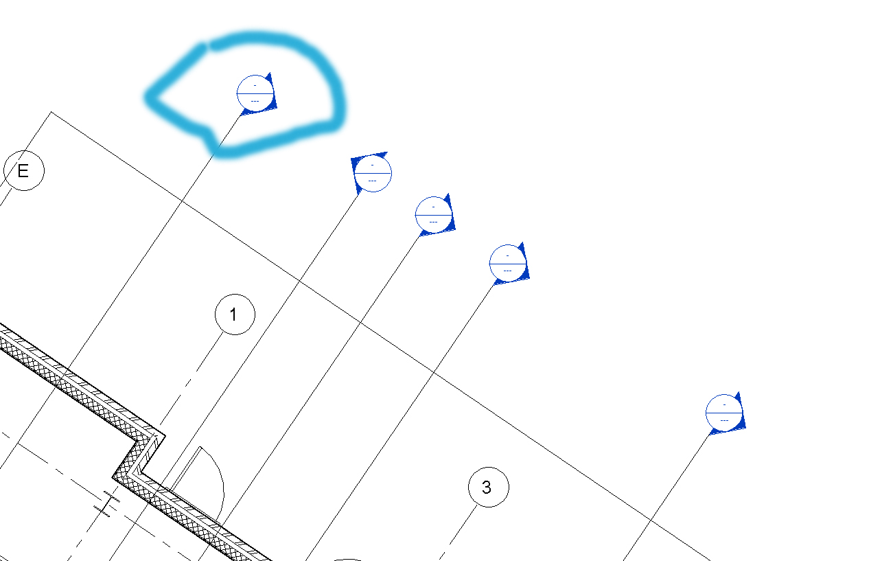

Thanks Gebber for your answer. I was able to change the coarse fill pattern easily. But about the section and elevation symbols, I mean on plans. I have no problems doing them in elevations and sections. But on plans I will like to show the sections and elevations numbers within the symbols. How do I do that?

I mean the texts within the callous of elevations and sections

See Image. How do I show texts in this Section Tags?
Mon, Jul 30, 2012 at 7:12:54 AM | Revit Detail Level fill pattern, Texts in Elevation and Section's Symbols
The text will automatically populate once you place the referenced view on a sheet.
